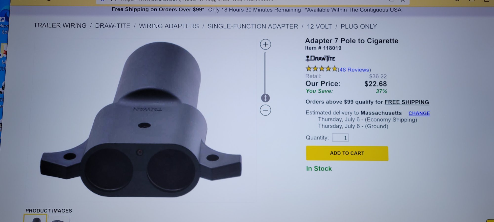

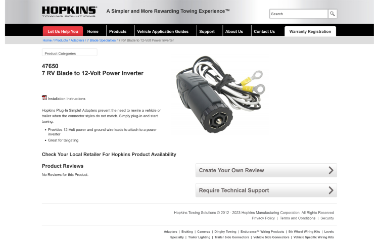

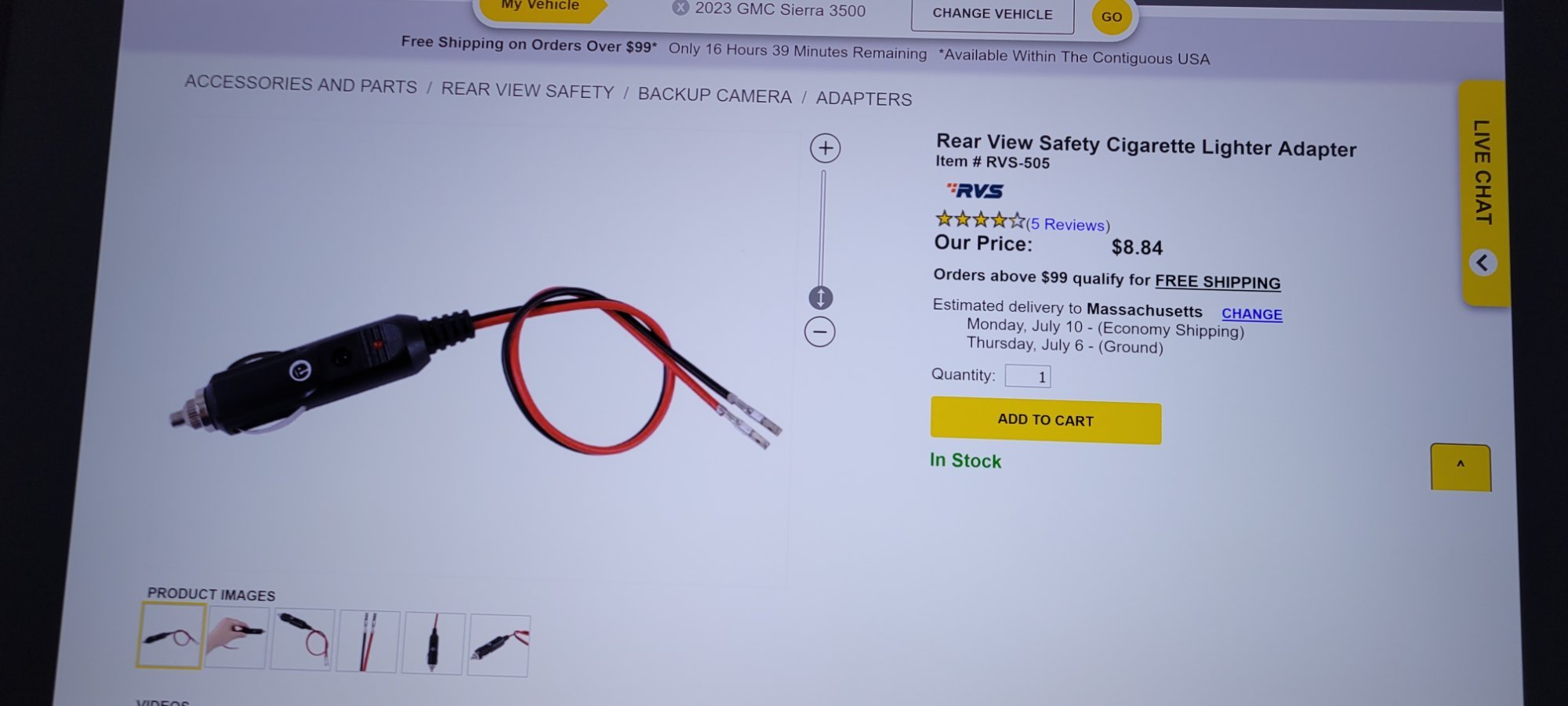

Fastest is to get something like a Hopkins Towing Products  # 4765, that plugs into the trailer 7 Way Blade recept., and has a two wire pigtail for 12vdc.
Or a Drawtite 7 Way to Cigar lighter adaptor , then a Cigar to 12v two wire pigtail. See all info attached.
I had a Cigar male plug that had two threaded Binding posts on it ( Red & Black), to put wires into it. Darn if I can find it or where I bought it years ago.
Either way, there is an easy solution to get 12v. power back in the bed area.

I ordered the 7 way to 12v socket adapter.  Will try that out and report back.  I know it doesn't work on the newer Fords with the smart plugs back there.  The new GMs are also smart somehow as in they know when a trailer is attached.
I have a 7 way to Cigar socket adapter I saved for my new '24 HD, did not put on my temp '18 1500. Going to do it as a test, to see if the 7 Way still has the 12v. with the Ign. key OFF.
