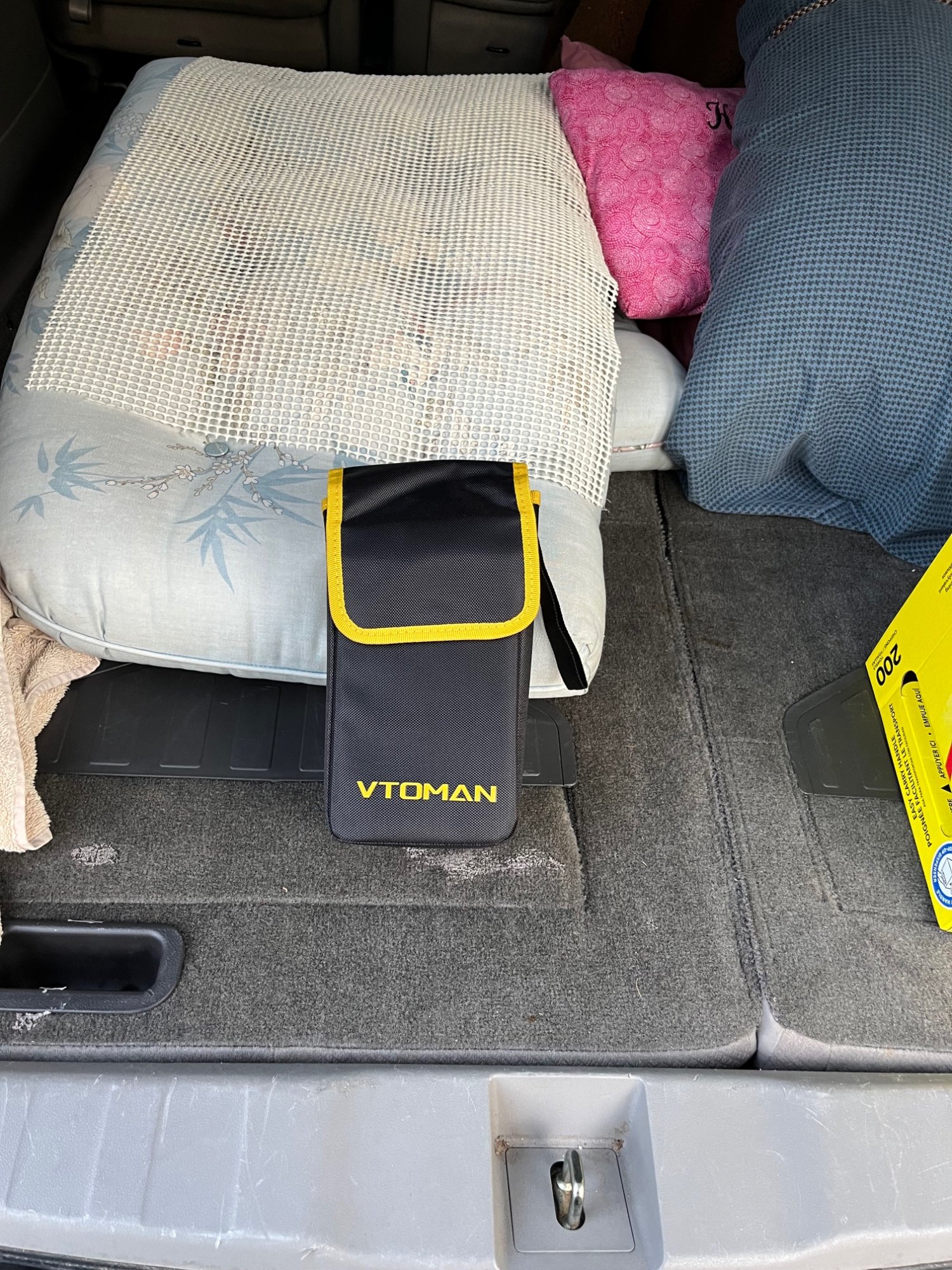

I’ve never seen the spare in my wife’s Genesis. Happened on the spare with the odyssey looking for a lost key. It was under the center console plate the console bolts to. The spare is under the floor behind the front seats. My avalanche is over 20 years old spare looks new. The problem is I’ve never had a flat. It’s true, never.  Maybe it’s the southern roads or my tires never see the wear bars on my trip vehicles. My town vehicles age out. Not that I don’t take precautions. I have a neat jump starter, air compressor combo. It’s been tested.
