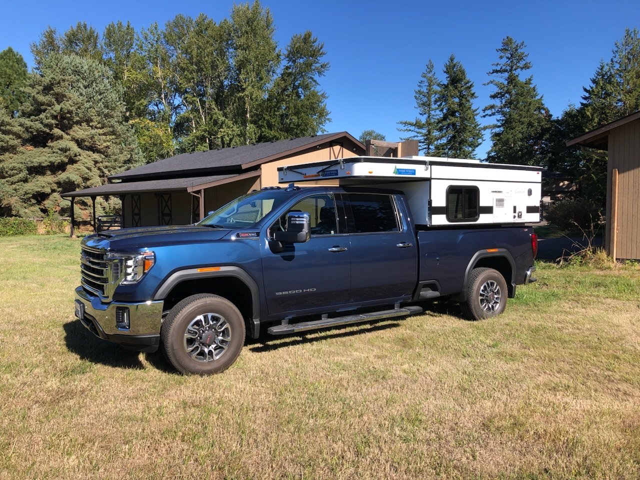

I have a Four Wheel Camper Grandby (8 foot bed) front dinette model with most of the options. I did my own lithium solar and dc to dc charger installations to save money and get exactly what i wanted for my power system. It weighs about 1800 lbs fully loaded up for camping - 1700 on rear axle and 100 on front axle. So I’m at about 50% of the payload rating. I have no suspension mods except I took out the unneeded 5600 lb front camper springs i originally ordered and put in the base 5200 lb springs for my model.
