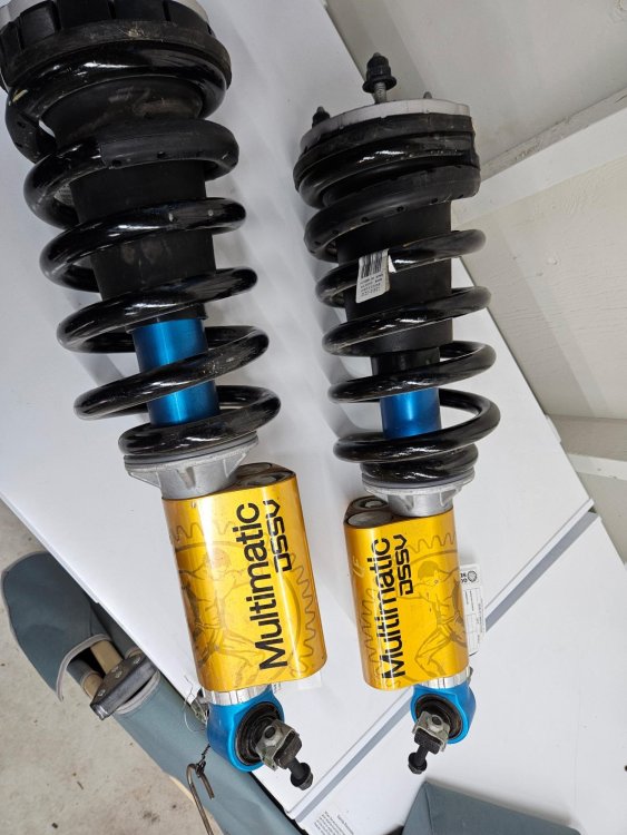

On 3/22/2024 at 8:27 AM, Chevyguy273 said:
Where did you find these for an unbelievable $200 for the pair?
pick & pull nearby - they definitely just listed the price wrong.... they screwed up but I didn't say anything lol
