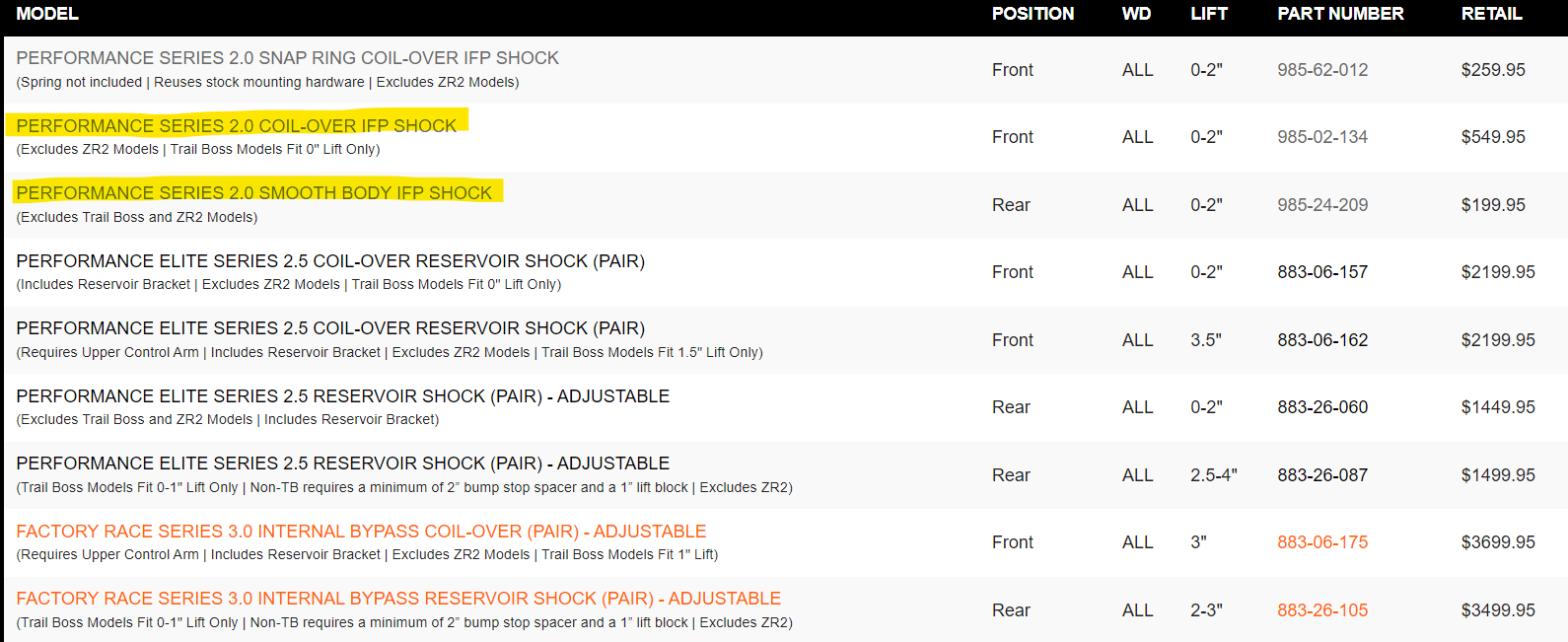

You think these 2.0s (highlighted) would fit the bill then? Do you think they'd still yield a much firmer ride than those Monroes?
Yup, those are the ones that come with a new coil. The one above needs a stock coil
https://www.shocksurplus.com/products/fox-2-0-performance-series-coilovers-shocks-set-for-2019-2024-chevrolet-silverado-1500-4wd-rwd
Here are the stock coil version, which may suit you better honestly. Rears between the 2 are the same
https://www.shocksurplus.com/products/fox-2-0-performance-series-coilovers-985-62-012
