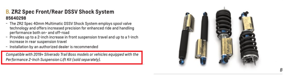

On 3/15/2024 at 1:25 PM, SVG said:
Look into Multi-Matic DSSV's.
I just picked up a pair today for $200. Came off a truck w/4 miles on the ODO. These things are like new...
Got 2 questions for you..
1. Do I need the trail boss UCA to mount these?
2. Can I run the rears on the standard (non-ZR2) leaf springs?

Per GM you need the entire GM 2 inch lift kit installed before you can install the Multimatics.
Edited by newdude
I swore I had read something in the past about requiring the trailboss UCAs.... a 2" lift would be why!
Any aftermarket kits you could recommend I look at? Based on what I've been reading, I think I just need UCAs and 2" rear block + U-bolts.
4a09e8946875becda15707801ff44612cfddd1988adf6da2cae42c4e3ce038a2.thumb.jpg.f13125ca5646d6cecb5b6252c3bc70ba.jpg
 If your truck has the factory 2" lift you're golden. If not then probably yes, you'll probably need control arms and CV shafts.

Where did you find these for an unbelievable $200 for the pair?
