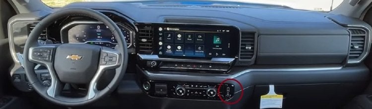

Some ports are only for charging.
It will work in the ones that are also data ports.
  • Thanks 1
So is it specific to certain trim levels? I would think that because my infotainment has the selection for USB for media input it should work on mine, which is a plain old 2023 LT. But it surely doesn't.
Edited by TrueBlue
Only these, unless there's more in the back. Never looked. But even if, these should be for power and data, if my trim level has data ports. Thanks.

If it has ports for the rear passengers they are likely charge only.
Ports for driver are data (phone, usb) and charge.
  • Thanks 1
I seem to recall seeing ports there in the back, but I can't say with certainty. I rarely have people back there and so what's back there is just not important to me. And I don't drive the truck everyday, or even every week so I'm not entirely familiar with its layout. But I think you're right about the front ports.
