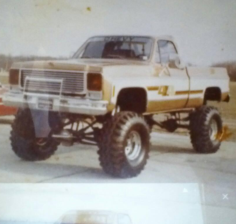

It would be definitely noticeable.
When I was much younger, the entire aspect of our camaros and corvettes was getting 4:11s!
Horrible for highway driving but drag racing was great!
My old Chevy truck with 40s, on 4:11s, though, worked well. 😀
