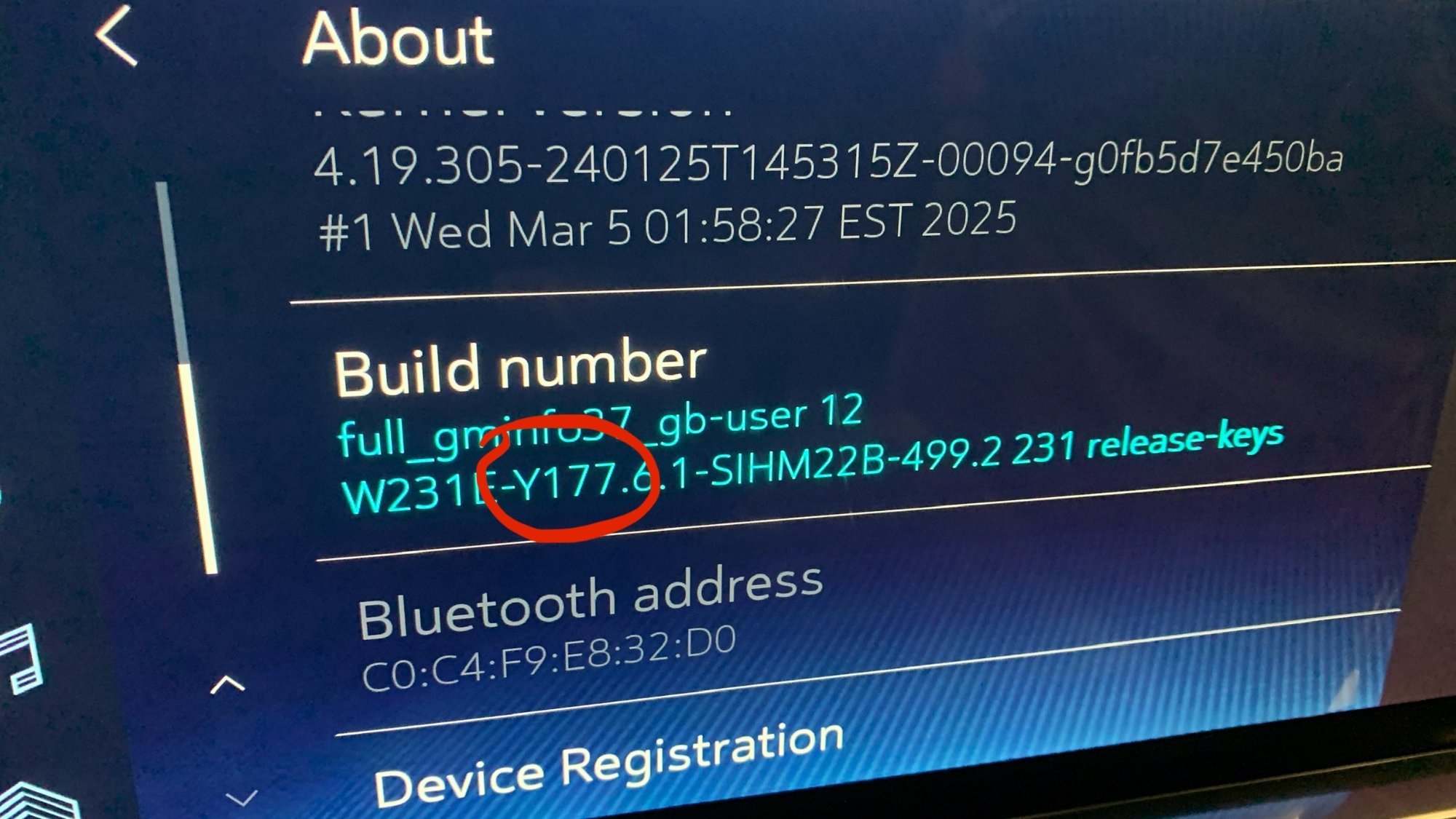

Radio updating is covered under Bumper 2 Bumper if you still are in that 3yr/36mi period.  You'd just have to express one or more of the concerns in the current radio update bulletin and they'd be able to flash it.
GM doesn't track the software via what level of Android Automotive it has, rather, they track it based on the build number.  Y181 is the latest and greatest software.  Example below of the page with the prior build Y177.

My build date is Y169.3.2 so I’ll give the local Dealer a call.
Thanks very much.
