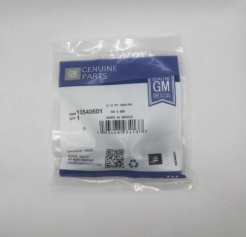

Counterfeit packaging vs. actual GM packaging on these TPMS:

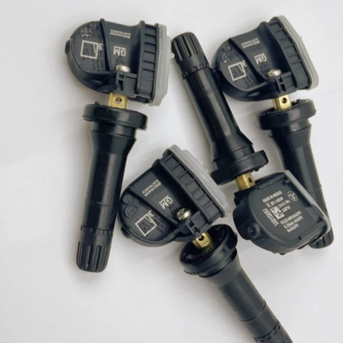

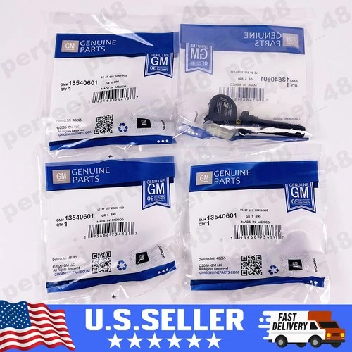

Counterfeits on eBay:
4PCS Original OEM TPMS 13540601 Tire Pressure Sensor for Buick Truck Fast Ship - Picture 2 of 4
4 Pcs 13540601 Genuine OEM GM TPMS Tire Pressure Sensor for GMC Trucks & Vans - Picture 1 of 4

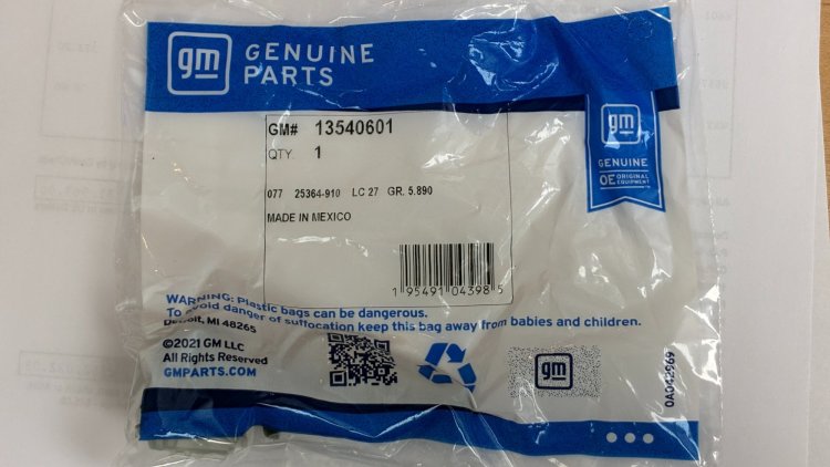

An actual GM packaging for 13540601 that I took right now:
If you look at the ones listed on eBay for example, most all of the listings are using the same 5-10 photos.  All the packages have the same Julian dates on them too.  So those top two photos I posted, the date is "22203" on both.  Year 2022, 203rd day.  Different photos from those listings, same exact dates.

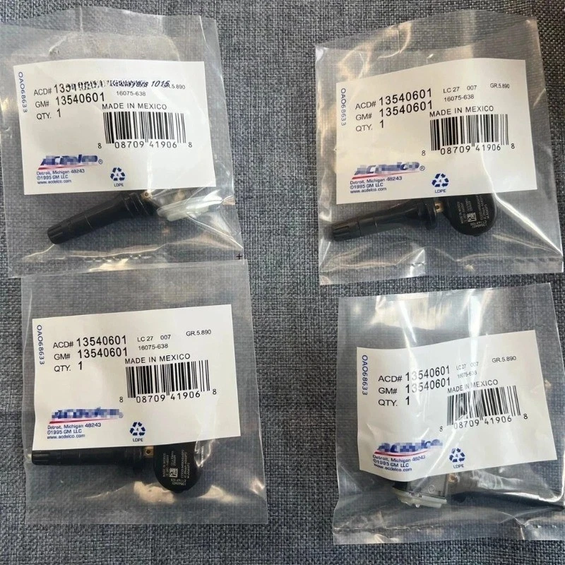

Here's a listing for 13540601 in counterfeit ACDelco packaging - 4 Pack- Genuine OEM GM TPMS Tire Pressure Sensor for GMC Trucks & Vans 13540601 | eBay
4 Pack- Genuine OEM GM TPMS Tire Pressure Sensor for GMC Trucks & Vans 13540601 - Picture 1 of 3
The Julian date on the package is "16075"  Year 2016, 75th day.
P/N 13540601 did not exist yet in 2016!!!    In 2016, GM was still on p/n 13598772, which that number went into effect September 2015.  13540601 replaced 13598772 February 1st 2023.  How is that possible?  Counterfeit.  To the unknowing, it looks legit.
