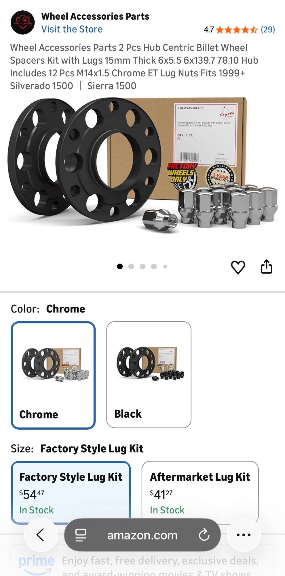

I appreciate the response and like your nightlight solution. Can you elaborate on a knuckle extension? That is new to me. Also, which 1/2" spacers did you go with? I found some 15mm billet hubcentric spacers on Amazon with decent enough reviews.

Do you happen to remember which 15mm spacers you got? Appreciate it.

Same ones I ordered. I appreciate it! Any issues with these at all? In your video it says you didn't need extended lugs, but you mentioned you're using the ET lugs that came with the spacers. Unless I heard you wrong. Thanks again.
You’re welcome. They are a snug fit into the bore of my factory wheels. I tapped them in with a soft dead blow hammer. I wouldn’t feel safe using the spacers without the ET lug nuts.

My mistake I thought that was your video. You know, I don't have factory wheels so I had to return mine. I've got aftermarket spacers from the same seller coming in. The others did not fit, but you're mentioning tapping them in. The thought DID cross my mind but I was not sure if that was the play. Glad you mentioned that.
The spacers are the same for factory wheels and aftermarket. The lugs are different though. The factory style ET lugs  have a larger shoulder diameter and larger hex size. They won’t work with my aftermarket wheels either.

Ah, so the spacers don't fit yours either? Did you find another solution/workaround? Maybe you already mentioned it but I may have missed it.
The spacers will fit, but the stock style lug nuts won’t fit through the smaller holes in my aftermarket wheels. They make different lug nuts to use with aftermarket wheels.

Strange. I ordered the factory style spacers from the same people and I could not get them flush. Thanks again for all the feedback.
