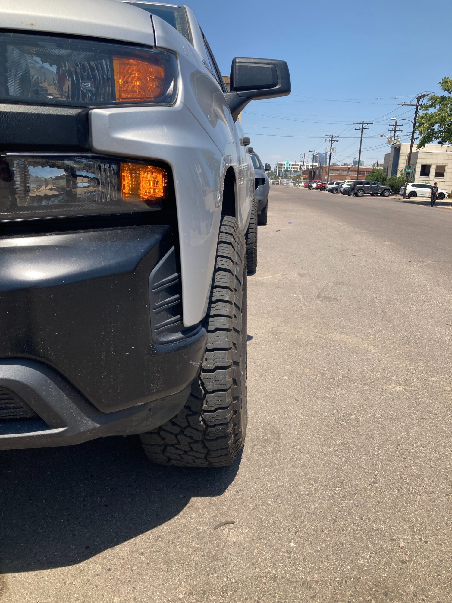

I got the new wheels and tires on.  The front is raised an inch and a quarter from stock with the Eibachs installed.  The wheels are  Motiv 427MB Gloss Black w/ Machined Face Accents 18 x9 with a +18 offset and tires are 285/70-18 Toyo Open Country AT III's.  No rubbing at all.  The tires are louder than I expected.  I got the impression they were kind of quiet from all the reading I have been doing online.  Not bad but you can hear them. :lol:

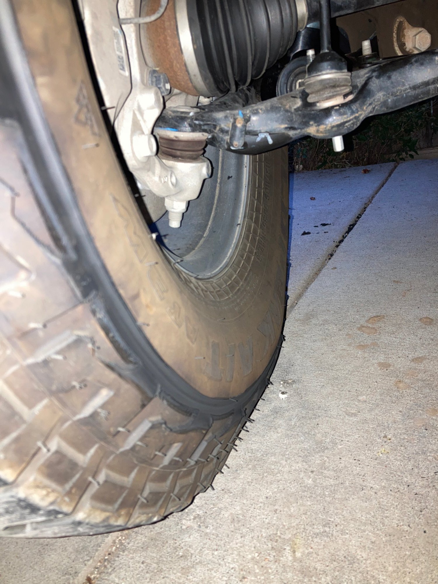

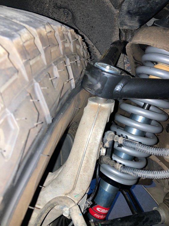

Howdy, I just installed the Eibach coilovers and shocks paired with Icon's Delta upper control arms this weekend. I took a peak in the wheel well this evening and realized that the tires are contacting the ball joint of the upper control arms and it's chiseled in a small groove on the sidewall already from the 10-15 miles I've put on since doing the swap. It's doing this on both side of the truck.
My tires are 315/70R-17 which is much wider than the stock 265/70R-17. However I've been running these 315 tires on my truck with the stock UCA's for almost a year now and have had no tire rub. Anyways, I'm headed to the tire shop tomorrow for an alignment and wondering if the alignment will fix this? I know my alignment is way outta wack since the lift & new UCA's so I'm hoping that'll fix the problem. Also hoping I haven't damaged my sidewall with the rubbing, too.

No, an alignment will not fix this. It will not change the spindle to A arm relationship. But some wheel spacers will 😉
That is a bummer, but I guess that's what I get for going with a much wider tire. I really did NOT expect new upper control arms to have this effect, in fact I was thinking it would have a bit of the opposite where I would gain a bit more clearance.
Just dropped off at the tire shop so I guess I'll wait to get a call back from a tech, but I'm with you @Black02Silverado, I've never used spacers and not a fan based on what I've read about them in the past - and I wasn't looking to replace with different offset wheels either. Guess I'm just bellyaching at this point but appreciate your responses. I'll update on where this ends up.
I guess my next question (because this is the first time I've installed new uppers) - why did the 315 tires NOT rub on the stock UCA when I was running a stock suspension? Thanks.
Edited by Rocky-X
Update:
As @Grumpy Bear and @Black02Silverado said - the alignment did not fix this issue so I now need to find new rims with enough of a negative offset or backspacing to clear the ball joint. Tech also recommended replacing the front two tires from the grooves carved into them which is a bummer - expensive mistake but I'm the only one to blame. Going to call Icon to see what they recommend for wheels as I'm not open to trying wheel spacers.
Fortunately that is the only options you have other than finding a narrower tire.  I personally like a narrower/taller tire. Not a fan of the wide. Unfortunately they don't make them narrow and tall, just fat. 😆
I also went with Cognito UCA's because they looked to be the least of the bunch for interference. I'm running the factor ZR2 wheels now with 285/70-18 Toyo Open Country AT III's I have a 1/2" between the UCA and the tire.
Edited by Black02Silverado
Different geometry. Your new arms move the location of the upper joint so that when lifted it doesn't stress the joint to failure.

Ordered new rims and got 'em installed today - they're Pro Comp 32's (17x9) with 4.75" backspacing & -6mm offset. They poke out of the wheel wells quite a bit so I'll be chipping paint on the rockers in the future but hey - they now clear the control arms! I have some plastic to trim behind the wheel well fabric, the tires start rubbing around 3/4 full lock - yeesh.
