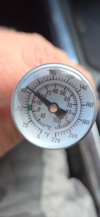

2024 l8t . Ac has never felt really cold even new. But lately it seems a little warmer. When it gets in the upper 80s and a little more humid it just does not keep up. And sometimes at idle it gets warm. My wife's 2008 envoy is better. My son's 2016 is colder. I have an apointment for a third try Monday the 29th at a third dealer to try and get cold ac before my warranty is out. The first two told me something about so many degrees under ambient temp blah blah blah seemed like they didn't want to mess with me. This was set at low. Max air fan speed high. 87 degrees and a little humid.

That a/c has got a problem. It should be able to put out at least mid 40`s temp on a day like that.
Vent temp, that is.

If that guage has a way to adjust [hex on bottom], put that thing in a glass full of ice, put water in, put your gage in, let it sit for 3 minutes or so, and set it to 33 degrees.
Edited by PunchT37
The thermometer has been in my wife's 2008 envoy, my sons 2016 chevy, my friends 2020 1500 silverado all showing cooler readings. It's not the guage.
