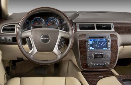

I was looking at a few 09 trucks and the models that did not have the dic had different vents than the ones with dic, if i do the mod after words then does the kit come with a different vent? the dic was to the right of the gauge cluster. I was looking at ext cab sl not to sure if that matters
This upgrade is not for trucks with that interior. This is for the trucks with the interior below.
As you can see in that pic the DIC is on the left hand side just to the right of the vent. This mod is to add the DIC for guys who don't have that set of four buttons already.
Ok, well what interior is that? from what i found out this up grade will only work if you have the 40/20/40 setting in the front? Any info on this will be great.
Thanks
