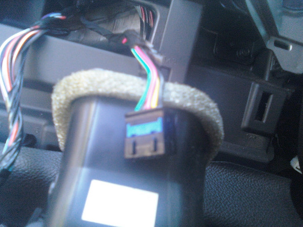

I pulled off my dash bezel today and I think I found the elusive DIC wire but I want to post a picture before I order the new dash plate just to be sure.
Thats it! :confused:
Sweet!!!! :confused::(
Daddy didn't lie when he said that this is the single easiest mod you could ever do! I'll be sure to post the results after I order the part and get it installed. I priced it at a dealership in Canada and was told $95 so that sounds about right.
Got the dash and switch and installed it right away in under 10 minutes!! Thanks Daddy for letting us all know about this quick and easy and oh so useful mod. :thumbs:
Definitely the easiest mod I've ever done to any vehicle I've owned! I plan to put it to good use when I make the 2 and a half hour trek to the campground this weekend!
