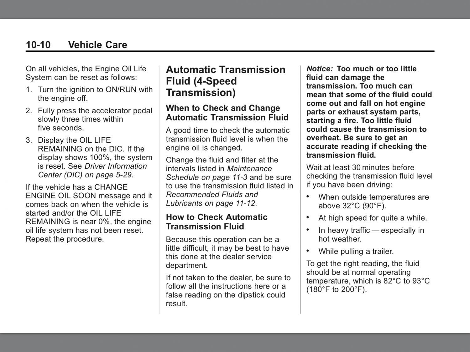

ignition on.....press pedal to the floor three times within five seconds. Watch for the oil life to do it's thing, open door, turn key off. Then turn key back on after it's all done to make sure it reset.

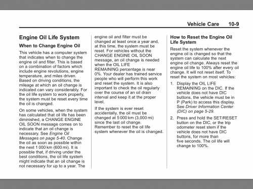

I have a 2010 silverado and going to change the oil. how do i reset the oil life? I dont have the dic option on my truck.

No that is correct for your truck not his.
Push the pin that gives you the odometer reading when it shows the oil life, hold it until it resets.

For those with the driver info digital display under the speedo, there's a quicker simpler way:
1 - Toggle to the low percentage oil life display.
2 - Hold in the "check-mark" reset button a few seconds.
3 - DONE! Back to 100%.
