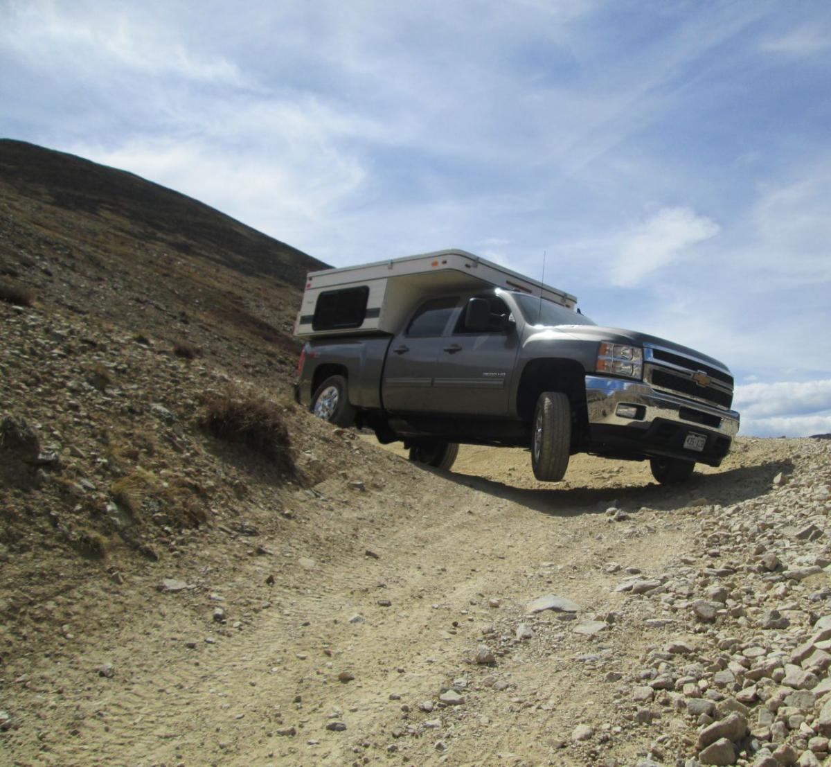

By tight frame do you mean stiff?
If stiff, YES they are, see on mine how the panels line up on a teeter totter.
