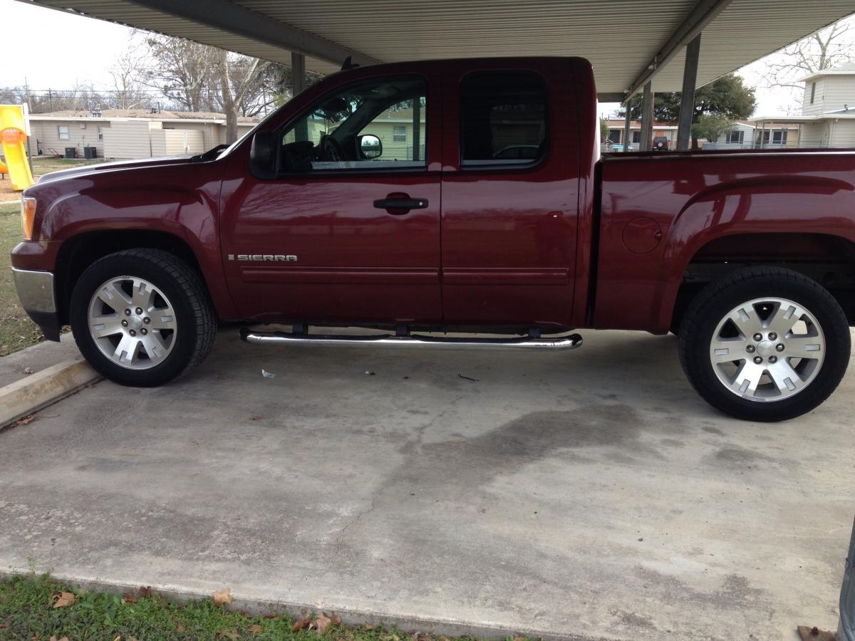

Kinda like these
Yes I feel those were the best looking wheels on any of the 900s. Were not an around and or an option for my 09. Would gladly take then on a '14.
