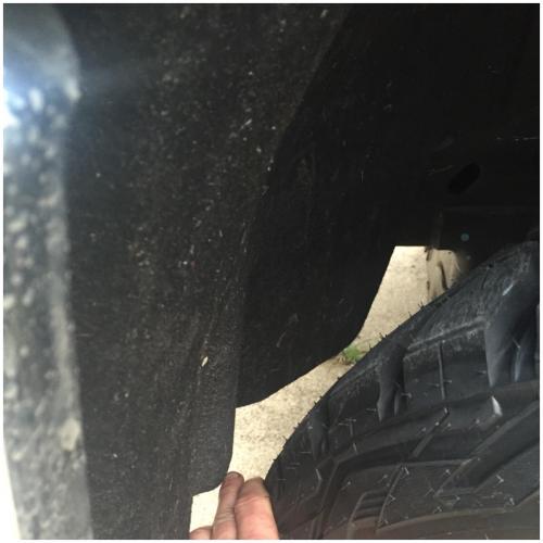

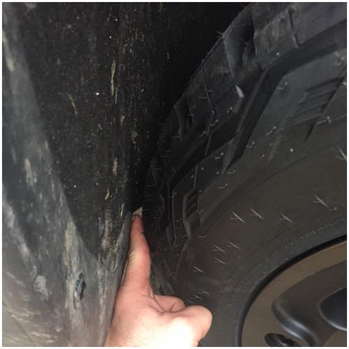

Truck looks great! Any rubbing from the wide wheels up front? If so how much trimming. Thanks
No rubbing at full lock unless I'm in reverse, and it's so minor I may just heat up the fender well & push it in.post-141567-0-20519300-1430192365_thumb.jpgpost-141567-0-50101500-1430192382_thumb.jpg
