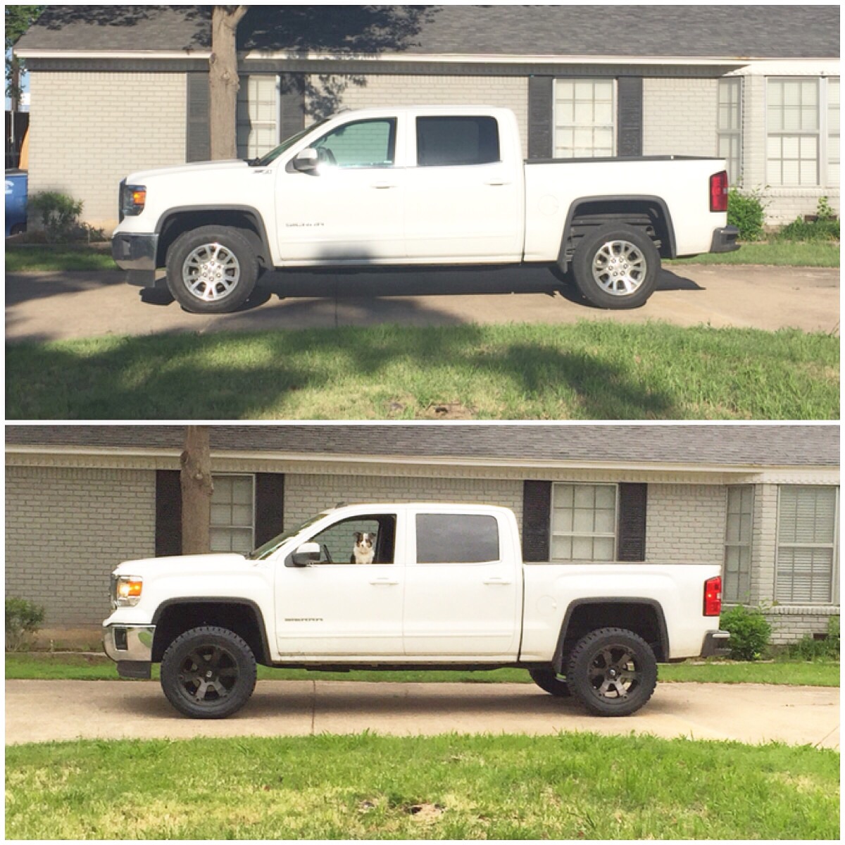

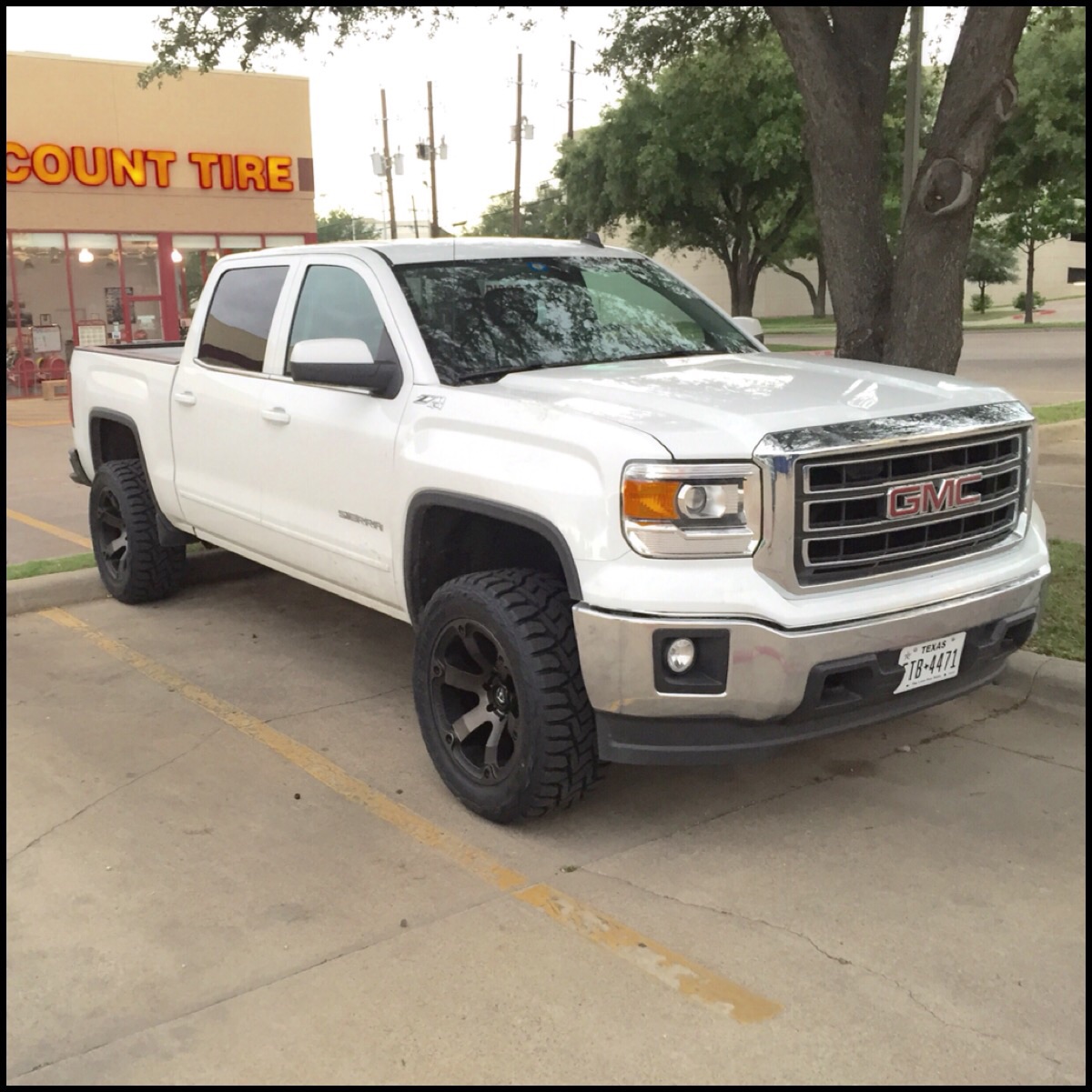

For reference to those debating lifts, here's mine I just finished along with my .
Fabtech 4" suspension
Fuel Beast 20x10 -18 et
33x12.5x20 Toyo Open Country R/T
The ride, height, softness of the R/T's, turning radius are all amazing and exactly what I wanted out of this truck. With the Fabtech kit, seemed like a bit much fab work for my liking (I did the lift myself). In retrospect, I think it would be better to accomplish the 4" from a level kit and 1.5" body. I had to cut off front diff cooling fins, a whole section of the front side of the diff, a section out of the lower driver's side control arm bracket, the upper control arm bracket stoops, etc.
With the Fuel wheels, I LOVE them. They're kind of greyish in pictures, but almost a magnesium/bronze color in person. What I didn't like about the wheels is you have to buy smaller aftermarket lug nuts, and the set I bought didn't seem to be acorning into the wheel tight and I ended up over tightening the nuts, stretching out the lugs.
Any questions feel free to ask.

Truck looks great! Any rubbing from the wide wheels up front? If so how much trimming. Thanks
