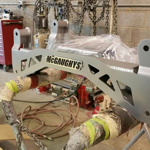

Just got my Mcgaughy lift in the other day going to be installing it this weekend.
