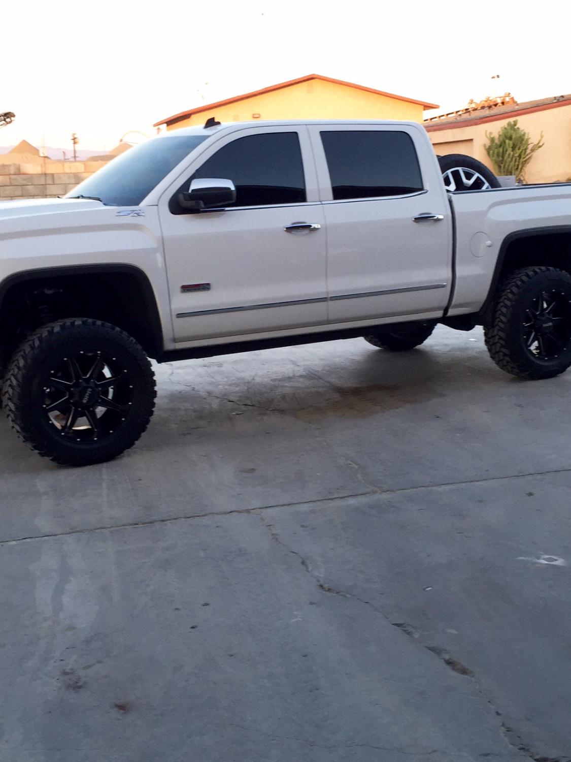

My ride, '15 Silverado LT Z71, 6" Fabtech, 35" x 12.50" 20 Toyo AT II on Fuel Mavericks, 20" x 9" (5" BS). Fits in 7' garage (82 1/2" actual opening height). I have about 1" clearance at top of Onstar antenna, had to cut the radio antenna about 6"-7". Color is Slate Gray Metallic.
Love your set up(simple yet aggressive) and Color of Truck! Is it 2 or 4WD? Could you post some additional photos down the side so I can see how far the tires stick out?
Thanks, it's 4WD and here's the shot down the side that you requested.

Are those the Fuel Mud Gripper tires?
Yes they are, they were on the truck originally and I didn't like the tire/wheel combo. I was able to talk the sales manager into letting me pick the tire/wheel combo I wanted. I told him he could use this set up on the next truck they lifted. BTW good eye.
