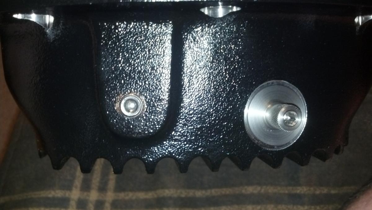

Here is a pic of the top of the cover that I was talking about:
Left port is the temp. sensor port, the right is the fill/drain plug hole
It is all the way at the top, unless the sensor is suppose to just read the fluid as it is flung up at it, which wouldn't make sense to me, cause it could really throw off a reading

Most diff covers that I have come across have the fill hole located in an engineered spot so you can't over fill the unit with gear lube. That one being on top of the cover scares me a little, especially since it looks like it would hold a larger amount of volume of lube than stock.

One of the purposes of the hole in the back is to help get the level correct according to Mag's own website
This it?
And that's what I read. You fill it from the top and keep that plug off.and when it starts to our out then you are at the proper.level
