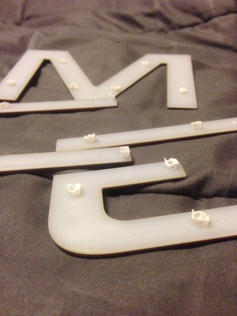

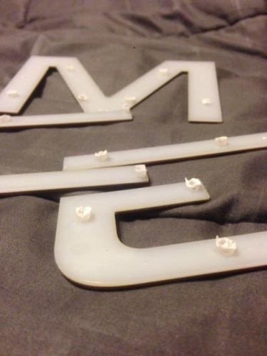

That's exactly what I was going to do with my emblem but couldn't figure out how to remove the red letters from the chrome. Did you just pop them out?
Can't just "pop them out". You have to basically drill out the white tabs that hold the letters in. These tabs ARE NOT THE SAME TABS THAT HOLD THE LETTERS TO THE TRUCK. The tabs you need to drill down are white and at key parts of the letters
You have access to these if you look at the back side of the chrome that the letters are sitting in. Just be careful as to not go all the way through and go through the letters themselves! Would make for a real downer if you put a big hole in the letters themselves.
He used a pick to pick at the white tabs until he could remove the letters.
