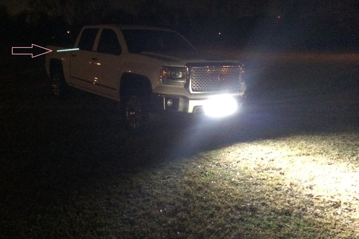

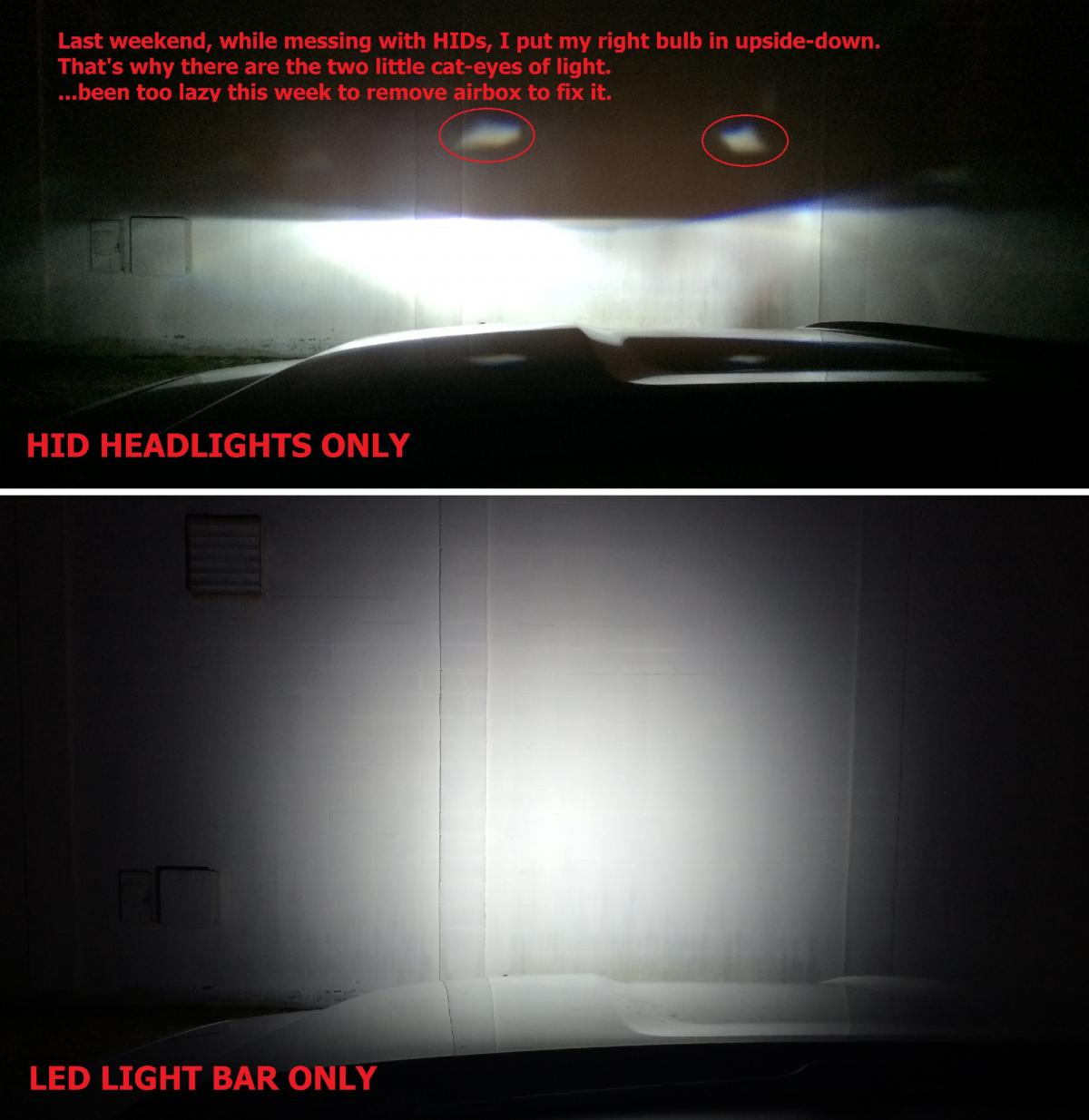

Light bar is installed & wired..... BUT instead of down now it's angled up about 5 to 10 degrees! Looks like I ground down the brackets a little too much this time! You can't really tell it's off unless you really look at, but it does decrease the lights effectiveness past 30 yrds. I need a break from this project, so I'll try adjusting the brackets a third time next weekend.
Pics attached below. If my HID headlights look a little off, it's b/c the right bulb is upside-down. Need to fix that tomorrow. Also, in last pic you can see the light's so bright the iphone camera messed up... I got a faint ghost image of the light bar near the truck's bed (pink arrow). ha
