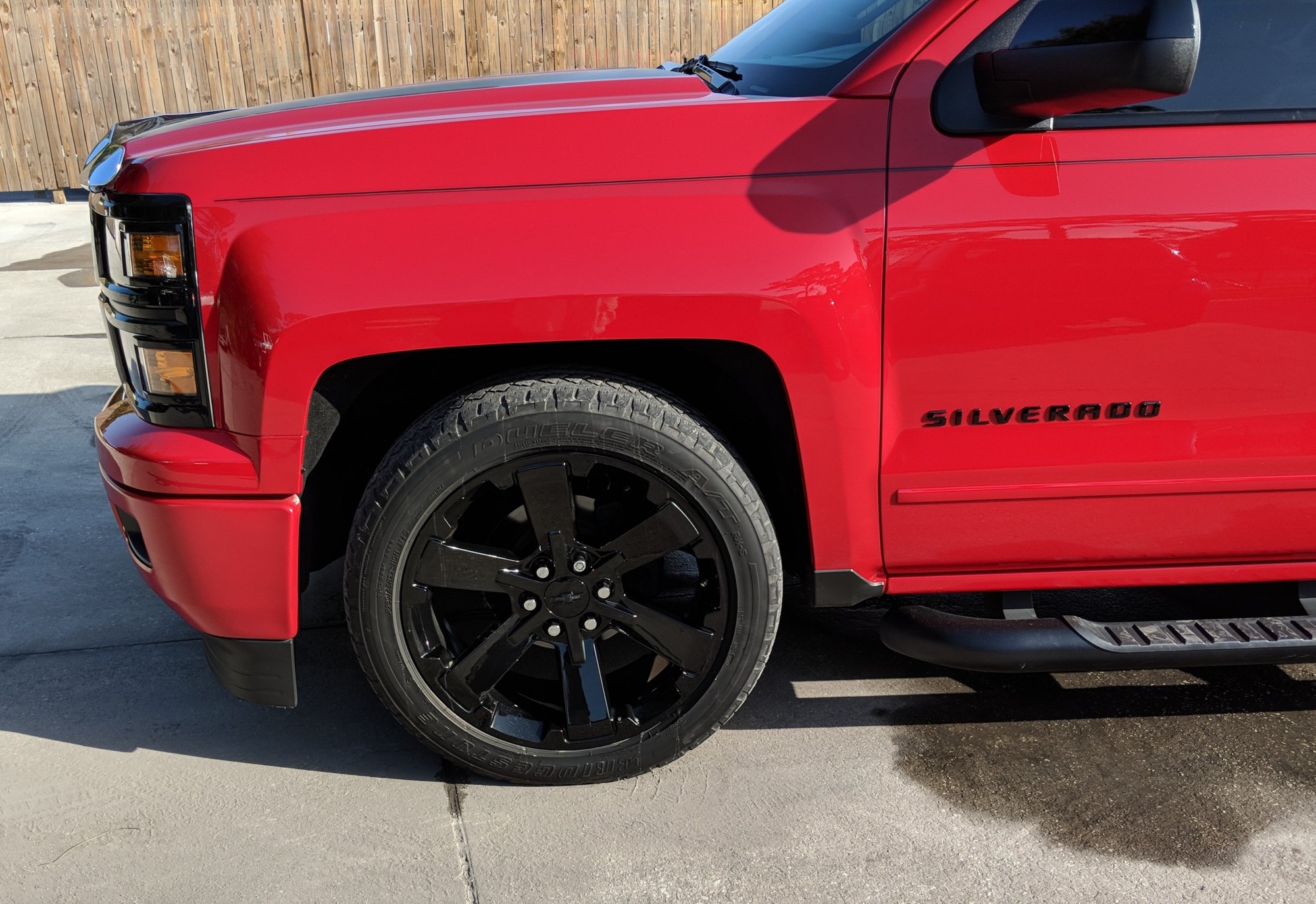

Well apparently I am the exception because my wheel is quite a bit back.  The stock UCAs are adjusted as much as they can be and it is still back a lot.  Is there a way that the spindle could be installed wrong to cause this situation?  Not sure if the picture does it justice but this is post spindle.
This is with 4 inches upfront. The wheel moved back about an inch or sob8340447bc99c4a96d372eeb61d16d16.jpg583b137b956a2cfbfd332ba0e49922d7.jpg

That looks stock
Sent from my SM-G975U using Tapatalk
Its not.  Picture isn't doing it justice.  Rubbing is only along the rear of the wheel well and occurs with just over a turn and a half.  Besides if it were stock then the IHC wheel movement was basically the same.

That looks a little better than mine with only a 2 inch drop upfront.  Your driver side looks better than the passenger side in the pictures.  Is that what you see in person?
Mine is the same. Drivers is less
When it was at 4 upfront yeah that's how it looked in person, since then I've moved up to 3 inches because the rubbing was bad. I refused to go with a smaller tire and I've never really checked the gaps ever since tbh

Will the TMW UCAs fix that difference?  My alignment tech said he couldn't move the wheel any farther forward because the stock UCAs didn't allow it.  I ordered the TMW UCAs after seeing your endorsement of them because they are more adjustable.

Looks like you are running the 20" rims with standard tire size, correct?  I have 22's with 285/45 tires (stock tire size for these OEM rims).
Yes correct.
