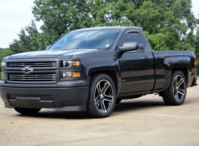

I have a 2/5 with no notch.
On 11/10/2018 at 7:21 PM, qwank said:
My truck with a 2/3.5 drop for reference
Truck looks great !! Getting my 2/4 drop installed tomorrow on my 16' reg cab wt. Might have to change my wheel/tire setup. currently running 20x10 -24, 295/45/20. so my wheels stick outside of fenders about 1"
Edited by cmb570
