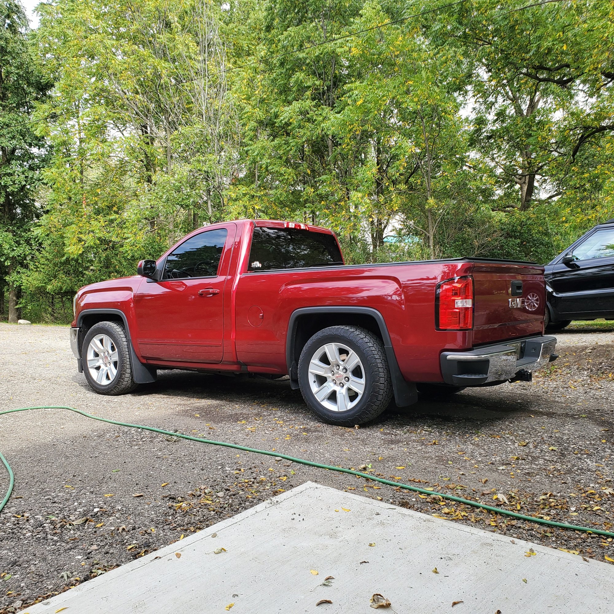

Finally got around to dropping the truck. 2" belltech spindles and belltech flip kit at 5". May go another 1-2" up front and 1" in the back next year.
On the look out for street tires, but until then. I'm happy with it.
Truck looks great. I would drop rear another inch but other than that it looks good. I like that color.
Had it at 6" originally, looked like it was squatting, so put it back up. Plus I do still tow and use the truck so I wanted some rake.

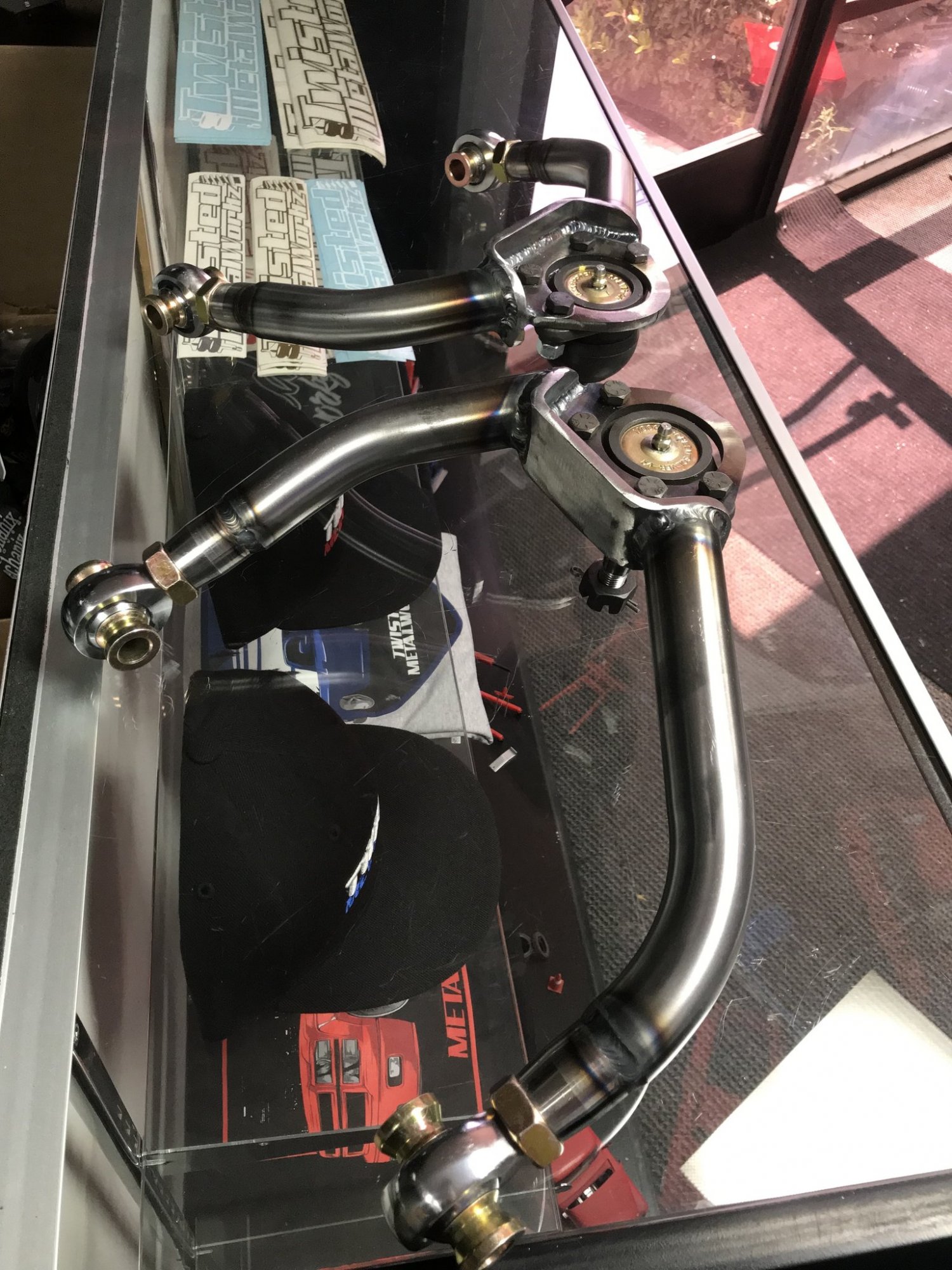

Got the Twisted Metal Workz upper control arms installed on my truck today.  It was late and I didn't have time to snap any photographs but will try to do so in the next couple of days.  The wheels moved forward as advertised.  They only rub right before full lock now.  Lot of money/time to move the wheel forward about a half inch but I am happy with it.  Looking to get rid of the last bit of rubbing I can either go down a tire size or potentially step down from my 1.5" wheel spacers to a 1" spacer.  I don't want smaller wheels as I like the look filling up the wheel well like they currently do.  The spacer change I might do.  I went with the 1.5" spacer as I understood that smaller spacers would require trimming the bolts and I wasn't sure I wanted to take that step.  Now after talking with my installer he said it was no big deal, and that basically it is something they do regularly (my paraphrase).  Any one here had that done?  I do like the wheels sticking out but I have thought since ti first got done that I really would like them to come in that 1/2".

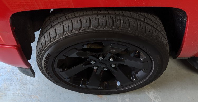

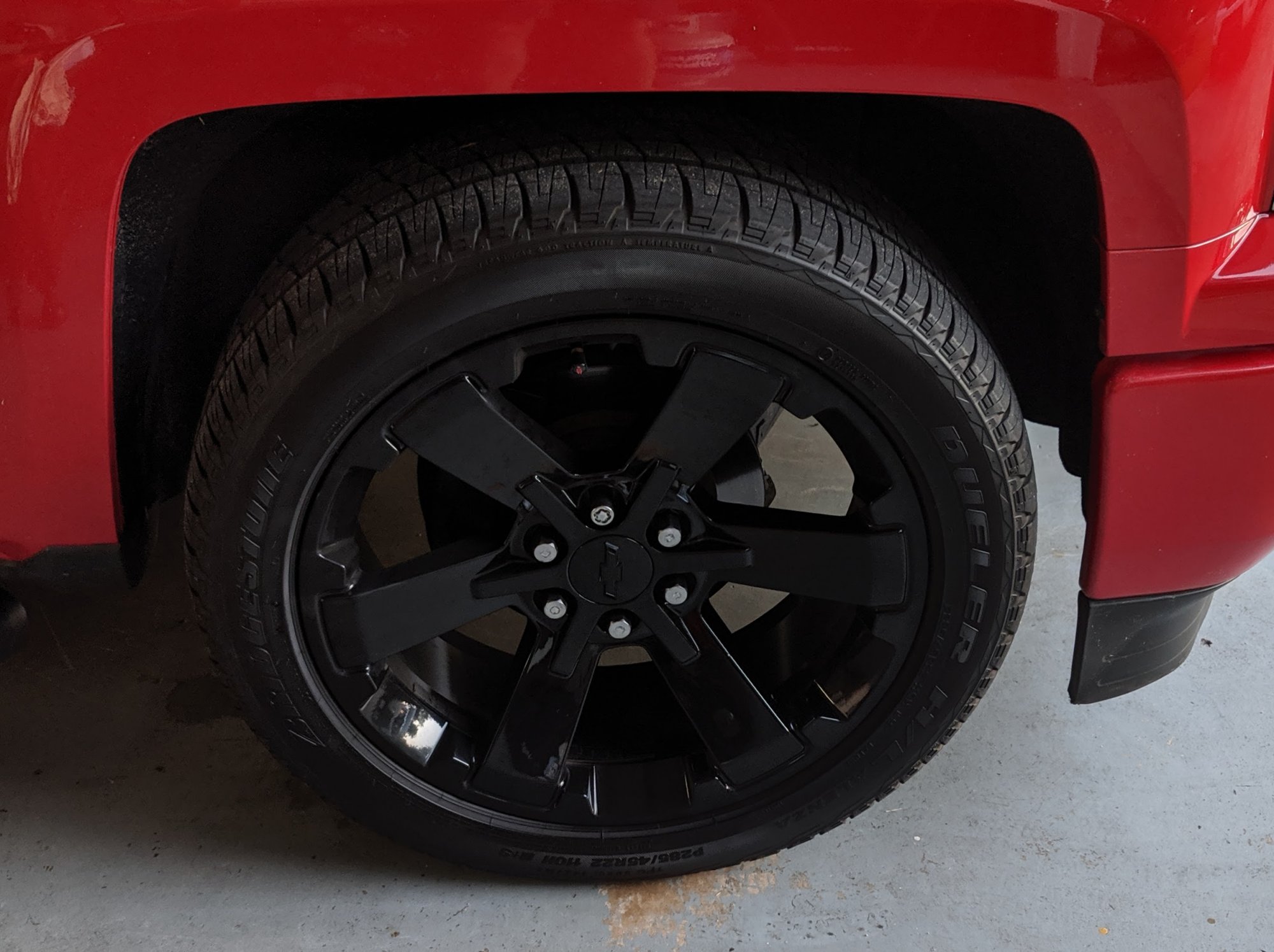

Here are pictures of my front wheels.  Damn near centered.  Very happy with the new arms.
