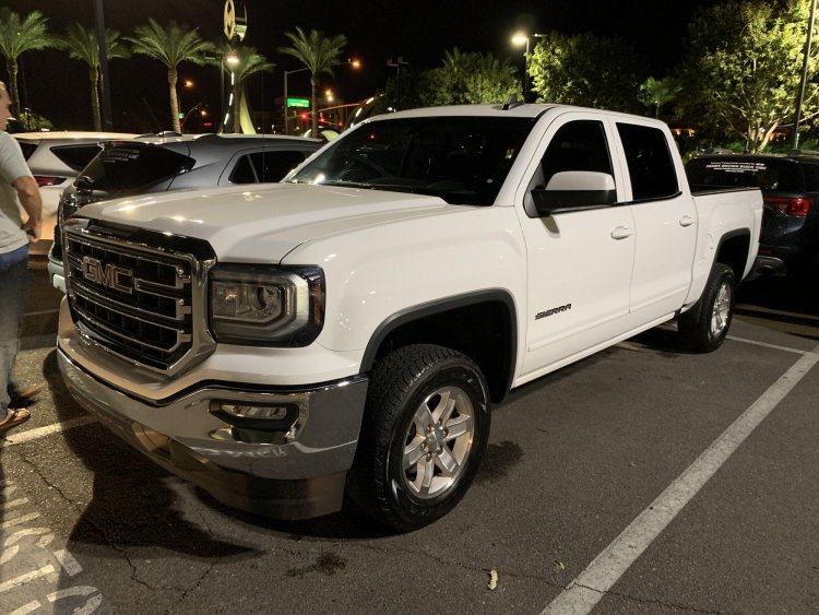

I want to get a 4/6 drop and put some 24" on it but Im worried about rubbing in the front and not sure how much clearance I will have in the back. The kit I was planning on was/is the IHC Suspension lowering kit.
They do say to cut off the bump stops but I dont care to much about that.
Hi Guys, I just bought my truck (2017 GMC Sierra 1500 SLE Crew Cab) a few days ago and just found this forum! I was hoping to get some input from yall.
