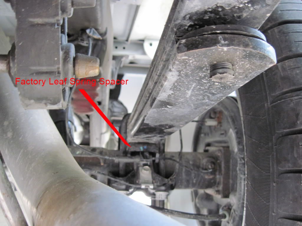

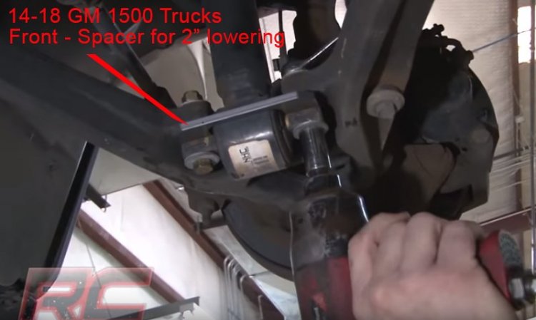

I have been considering a lowering my 2014 Sierra 1500 2WD but I really dont want to make any permanent mods to the truck like cutting off the rear leaf spring attachment brackets. Im really only looking for a 2/4 drop in height and found plenty of kits for this but all seem to require removing and replacing the rear leaf spring brackets.
The Rough Country 2/4 drop kit utilizes a shim/spacer to relocate the lower strut connection under instead of over the lower control arm. Its supposed to be good for a 2" drop at the front. And several places sell 2" drop leaf spring shackles.
So Im wondering if I used the Rough Country type front strut relocation shims combined with some 2" drop leaf spring shackles, plus removing the factory 1" leaf spring spacer, could I achieve a legit 2" / 3" drop?
 Overall it should work without any permanent mods to the truck. Just wondering if anyone has combined all three of these techniques and if, were you happy with the results? And if this works, does anyone have a work around to get the extra inch making it 2/4 drop?
Do not use that kit. Its horrible

Thanks for the reply. I was actually considering a hybrid set up but it sounds like you and others advise against the strut relocation to under the control arm. If thats the case then wouldn't a common solution to be to install a shorter strut and retain the factory mounting location?
Also, are you saying extended leaf spring shackles are a bad idea to?
