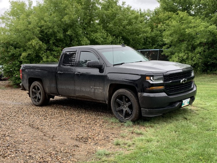

Was hoping to do a little more before posting but... The hillbilly package is partially uninstalled.
2” McGauthys Spindles
2” McGauthys Shackles
Niche 22” M192 Altair Wheels
Lionheart 285-45-22 Tires
Ventshades
Retrax Tonneau Cover
Trailer hutch delete (not needed)
4X4 Decal Delete (working on custom “Blackout” graphics)
Dirt ?
Looks almost level in this pic, must be the ground. Still need to remove the rear block.
Edited by krunch
