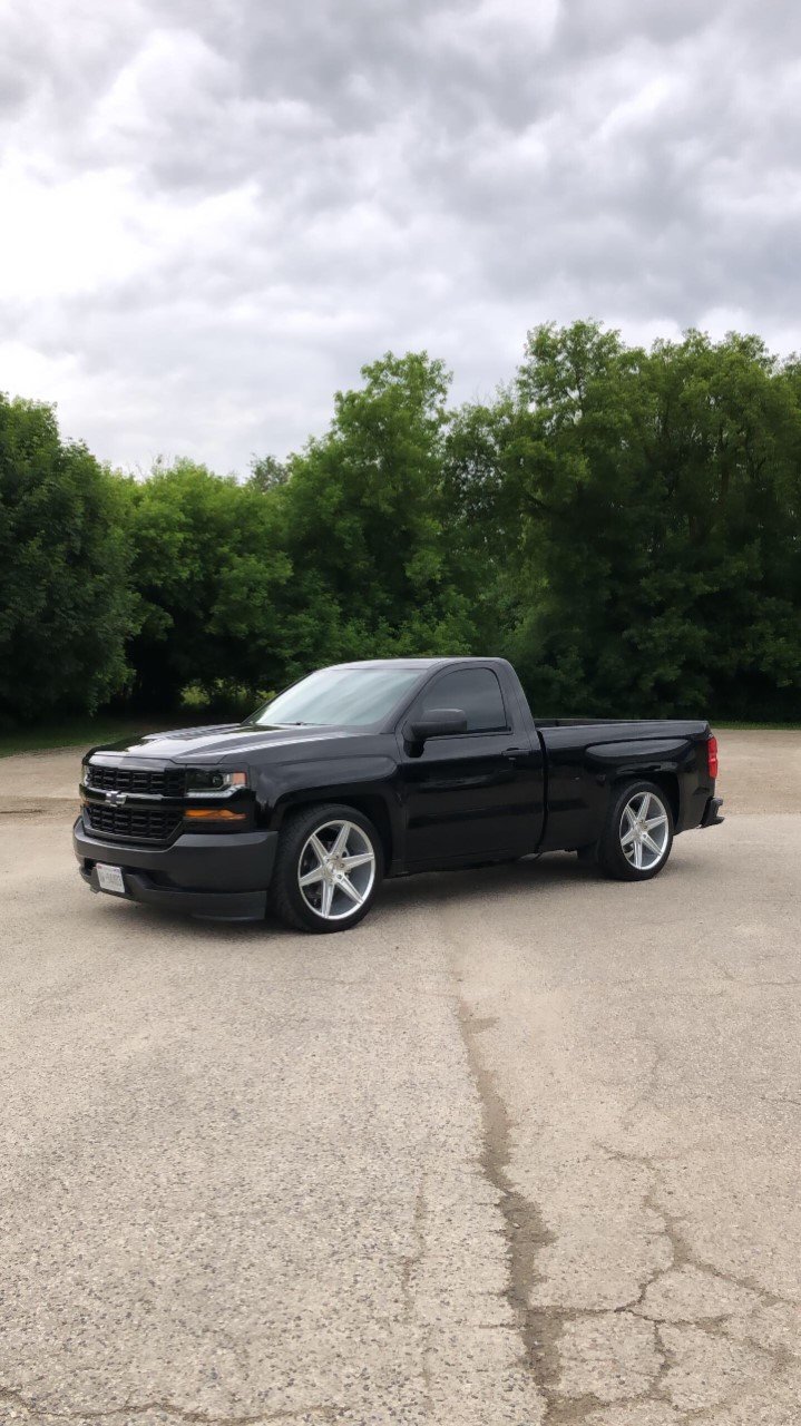

7 minutes ago, Dinner said:
Haven't posted in awhile - At least since I've installed my new wheels.  22x9.5 KMC Prism Truck in brushed silver wrapped in 285/40R22 Nitto 420S - Super happy with the look but dealing a slight vibration around 115-120 km/h - They were a bitch to balance so thinking I need to re do them or see if I have a rear bad tire.
Also, finally removed the PF strut spacer to level out the front side to side and got my camber adjusted to a more respectable amount (-0.8 to -0.9)
Full paint correction and ceramic coating too.
Looking into going lower eventually. Would like to do 5/8 or 6/8 with twisted metal works upper arms, either their coil over kit or Belltech coil overs, then twisted metal works under bed notch with either Viking or Ridetech adjustable shocks - These Belltech SP shocks are just too damn stiff on these K2 trucks
I have a custom twisted metal works notch if your interested. The stock ones you are able to go 10" drop on the back.  I had then make mine so I could go about 8 maybe 9 in the rear.  But I'm not notching my truck anymore
It'll be a while yet before I pull the trigger. I feel like I'm in the same boat as you with going lower and having to start cutting. There's a few local fabricators in my area that I'm talking to see if I'm comfortable with them getting into this thing. I know it sounds stupid but I'm hesitate to molesting vehicles

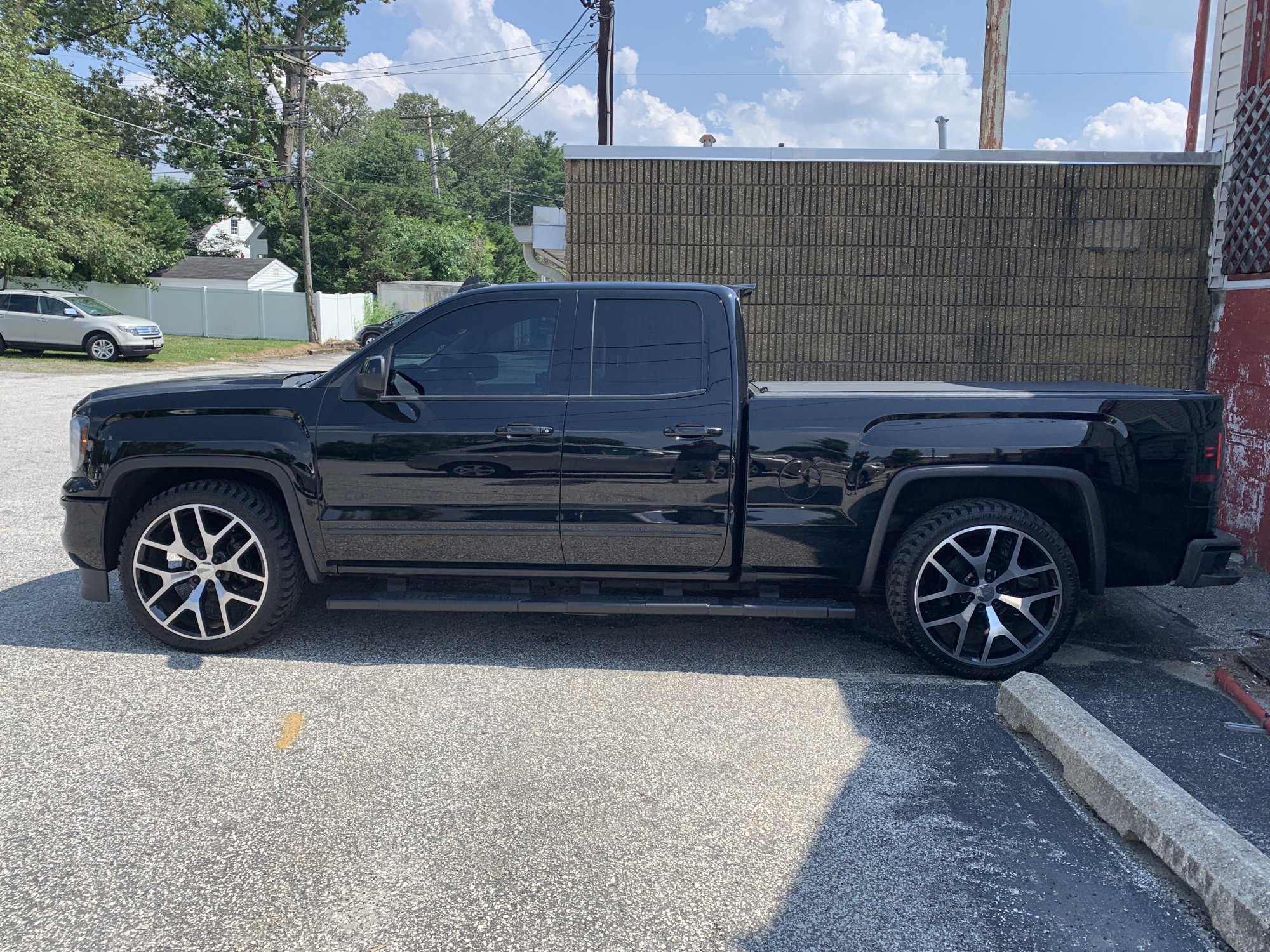

Very happy with the 2/4 Drop.  Only real issues seems to be turning when in Reverse, and slight vibration at 65mph.  Went with Adjustable Bilstein 5100 up front with Drop Spindles.  Actually considering raising fronts to reduce reverse issues.  Is it advisable to use lift strut with drop spindle?  Already cut away carpet and some plastic where contact happened.  Still only have 1/2 lock while backing up.
Most drops use an adjustable strut to go lower combined with drop spindles, so I don’t see why not. I probably wouldn’t go to the top ring though haha!
Are those Trail blades? Looks like an aggressive sidewall for a lowered truck.
Looks great!
