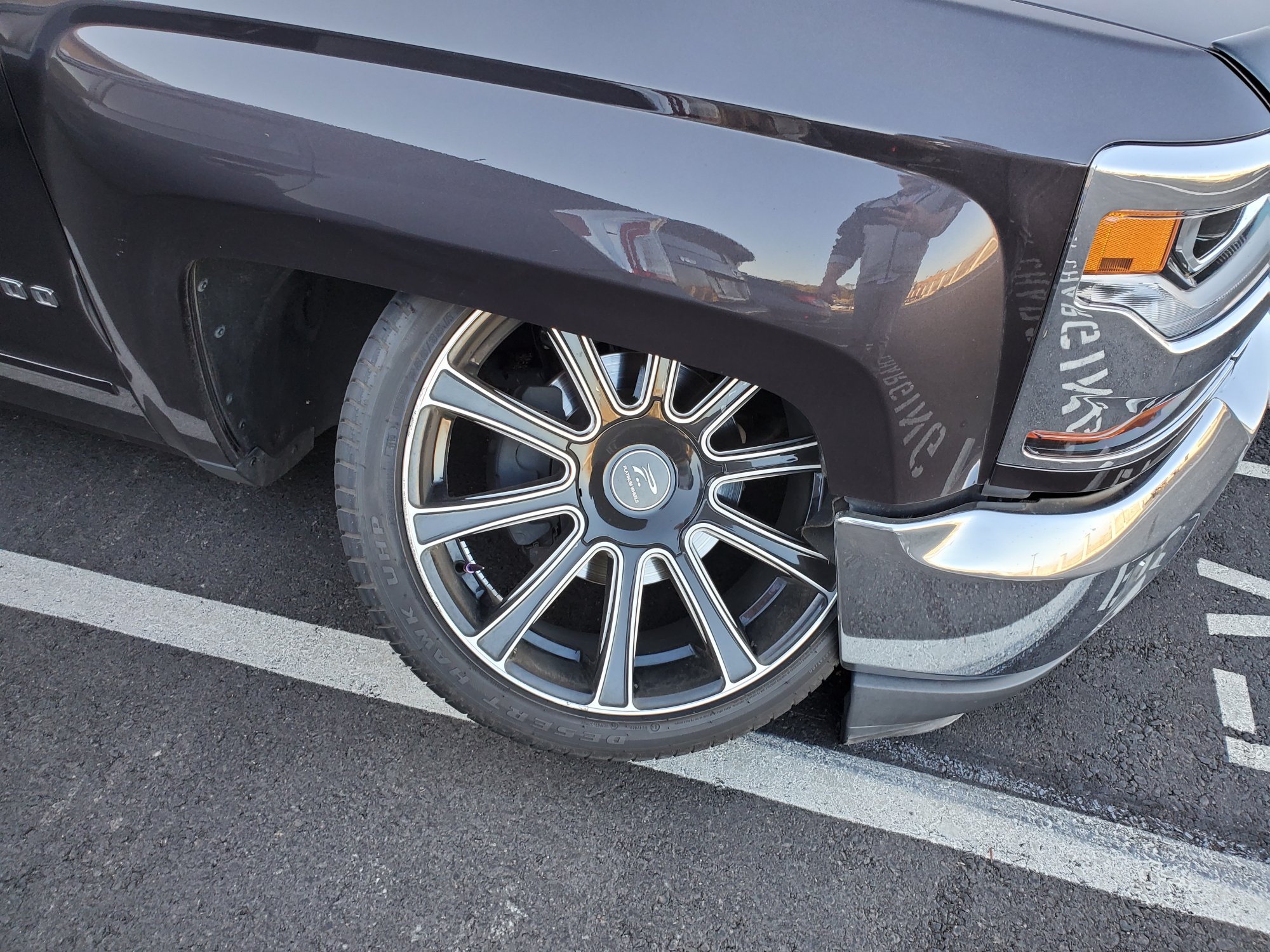

Just FYI for everyone... I can no longer say anything positive about the IHC 4/6 lowering kit. I have broken both lower ball joints due to the extremely cheap Chinese joints used in the kit. This was confirmed by my shop. I have since had both lowers replaced with Moog joints but am stuck using the Chinese upper ball joints because they are smaller than any GM upper ball joint available in Moog.
Total cost to fix the joints and associated damage and misc... $1700.
While the IHC crew had great customer service I can't in good conscience tell anyone to buy this kit until the various issues they have are adressed.
Lack of QC - I had to slightly drill out one of my spindles to accommodate a missized upper ball joint.
Lack of grease in ball joints - was told they were pre greased
Cheap materials - extremely cheap ball joints which becomes a safety issue. Luckily mine both sheered while reversing into a parking spot.

That just sucks. And one of the biggest reasons stopping me from lowering my truck. Imagine that happening to your 7000 lb vehicle at highway speeds.

I stuck up for IHC during that time but it was due to misinformation. The arms themselves are well built and my wheels are practically dead center but as @Nasty has stated, the ball joints are literal junk.

No. I had my shop put moogs into the lowers. The uppers are off size for any of the moog ball joints but had them put in higher quality upper ball joints. The kit is staying on for now until I decide if I go bags or not. My shop said the geometry of the arms is good but those crap ball joints are a liability.
