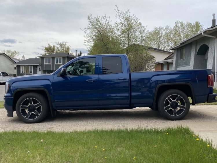

12 hours ago, 204-WPG said:
Have you tried 4/7 instead before getting new tires for now? My thinking is based on what you’re looking at 3/4-1” gap between fender and tires.
I don’t have a whole lot of adjustability In the front. I could probably come up 1/2 using spacers, but I really like the way it sits now. I know I’ll need new tires eventually to achieve the look I’m after.
the top of the tires is only about a half inch from the carpet liner in the front.

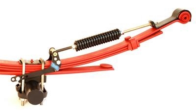

For Christmas I got the Roadmaster Active Suspension (RAS) to add to the leaf springs to help with roll and traction.  I haven't put it on yet because the system is designed for trucks without flip kits.  The system is connects the rear end of the leaf spring (which is not affected by the flip kit) to the middle section of the springs just in front of the axle.  With the axle sitting on top using a flip kit there is nothing for the front of the RAS to grip.  I think it will work if I put the stock 1.5" blocks in on the bottom side of the leaf springs.  Assuming the U-bolts are tensioned properly I don't think it would be a problem.  Anyone with experience or thoughts on this?
I would test this but I can only find one stock block from when I had the flip kit put on the truck.  Anyone have an extra stock block they could spare?  I want to use the stock blocks because they have the ridges on the ends which will hold them in place instead of sliding.  Hoping someone can help a lowered Chevy brother out.
