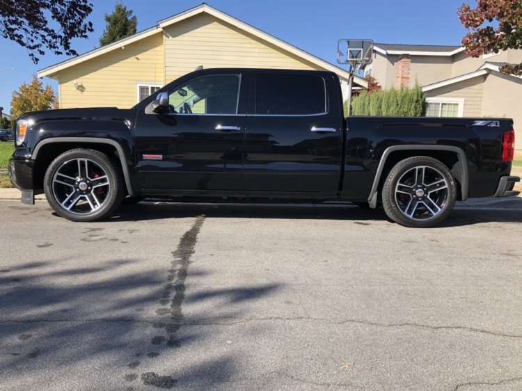

2015 gmc slt all terrain 4x4

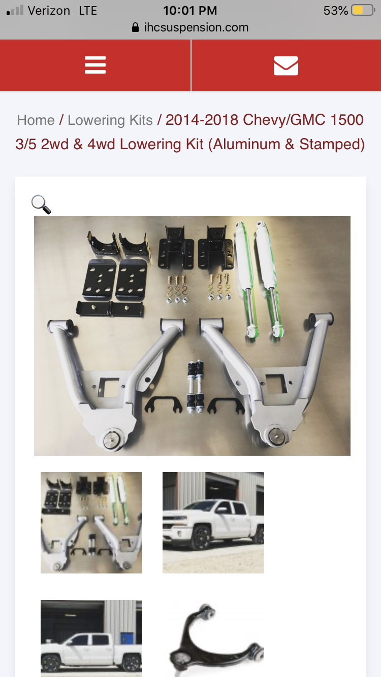

3/5 IHC KIT WITH HELPER BAGS
Nice truck, could you take a picture of the clearence between the axle and frame?
Also, how much was the kit and installation?
Thanks , kit was about 1160 install was about 900 with alignment
Damn, 900 for installation? Why was it so much?
labor on the rear reverse hanger install ,flip kit, shock install grind the bumpstop and air bag install for rear ,control arm replacement upfront ,tie rod trim and bushing install and alignment, then recalibrate all stabilitrac sensors and compass  . Other than that im not sure . i shopped it too lowest and best service i could find all prices were ball park the same but this kit is one of the best quality and best when it comes to alignment  , for those who know DJM this is like a 4x4 copycat version and the helper bags are a must to keep the towing functionality
