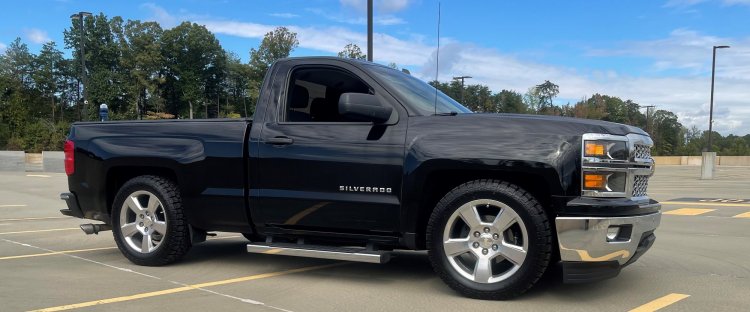

2014 Chevy Silverado std cab, 2 wheel drive 2/4inch drop made by Rough Country and purchased thru American Truck
Sitting on 20's....rides like a champ.
