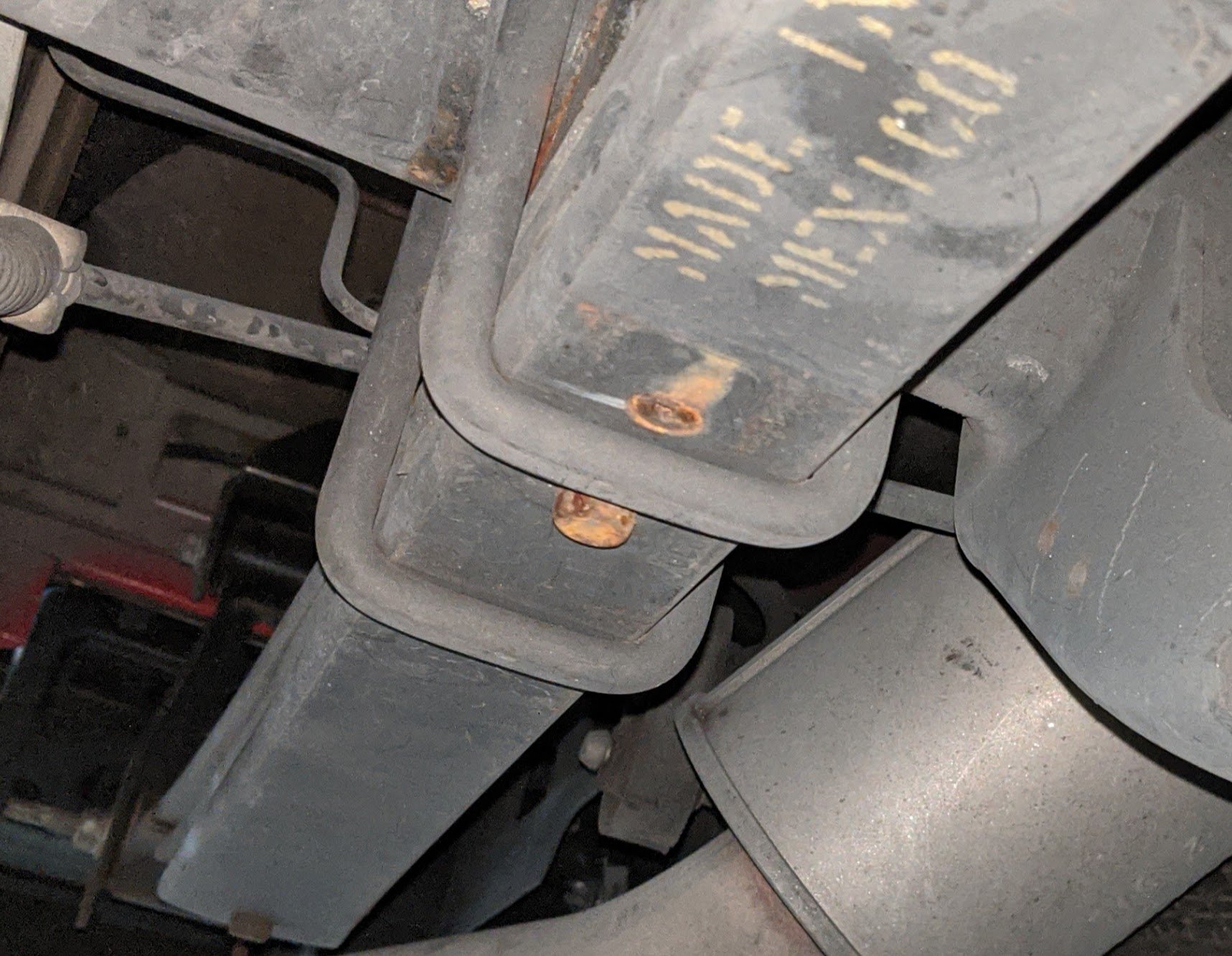

Need some help.  I have an issue with the rear wheel/axle that I need help to diagnose and fix.  I have 2" drop spindles in the front and a flip kit for a 4" drop in the rear.  I noticed that the rear wheels have been sliding backwards since I had my truck lowered.  In addition to noticing how the rear wheels sit in the wheel well I also got underneath and the axle has shifted backwards versus the leaf springs.  Not exactly sure what is causing this but suspect I might need to shorten the driveshaft.  Pictures below show the rear wheels on each side and one of the rear axle sitting on the leaf spring being off center (though that can be hard to tell from the photo).  Is this something to be worried about?  What do I need to do to fix it?
You are missing a plate that holds the u bolts in place. And the u bolts are going the wrong way.  U bolts should open towards the ground.
See picture below of plate and u bolt orientation. Who installed the kit? A shop? If so I would get you money back or have them fix it because you kit is installed incorrectly according to your picture.

Thanks for the help.  I did have a shop do it and I will take it back to them to get it fixed.

In looking more into the issue, the top plates are not to be found.  Since they installed the bottom plate on top they didn't install the top plates anywhere and did not return them to me with the other parts.  I have tried searching online to see if I can just find the 2 top plates but haven't had much luck.  I plan to try to call the different kit makers to see if any of them can help but figured it made sense to see if perhaps anyone in this group might have extras or a better suggestion for tracking the plates down.  Thanks in advance.
Call the manufacturer directly. I was one time looking for a part included in the kit(i use belltech flip kit) and could not find it even in their website. I think that was the same part you are looking, U bolt Spring Pad Mount, part number 6521-004). Out of frustration, I ended up calling Belltech directly. And i got the part i needed. It was explained to me that the specific part, like the plate you’re looking, will not show up in their website but you can actually buy it directly from them.
