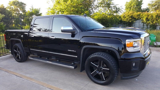

2" Shackles only did not remove blocks
Nice truck,,
