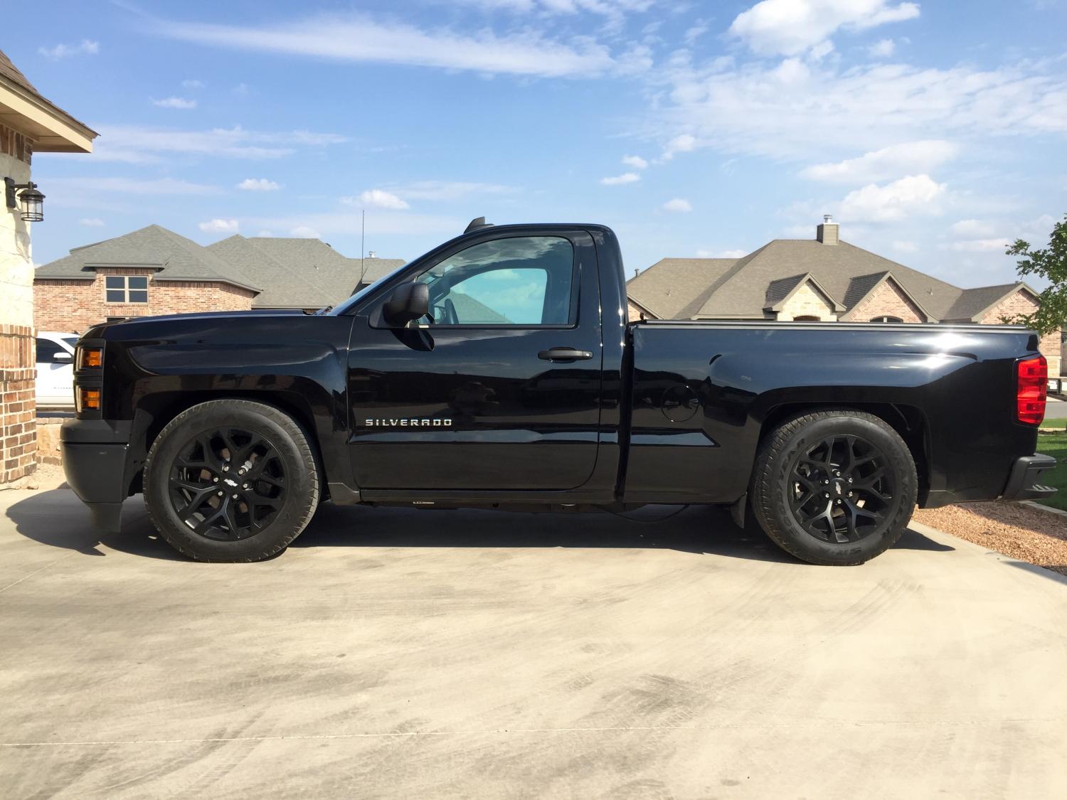

update: drop shackles installed and blocks removed. pretty happy with how it came out. some pictures make it look like the ass is lower now. see for yourself. i dont know why those pictures are turned, any info on that? haha
attachicon.gifIMG_1489.JPGattachicon.gifIMG_1492.JPGattachicon.gifIMG_1505.JPGattachicon.gifIMG_1507.JPGattachicon.gifIMG_1519.JPG
Your rear end is probably lower now, looks like it to me. Measure from ground to cab at the front and back of your cab, not from ground to fenders.
I noticed this on mine the other day after I removed my rear blocks.
yeah, it's exactly .500 inch different. I use a long solid stick, put it up against the tire to the fender, the gap on the two front and the passenger side wheels are almost the same gap, but the driver side rear have a big gap.

Got mine done, McGaughy's 4/7, but I'm probably bringing the back up another inch to 6.
Looks good...but you need to pull that brake cable back a bit so it doesn't bother me anymore... LOL!!! BTW I think your right raise the rear a little, rake looks tough IMO.

Good catch! I was so worn out last night from doing the rear I just dropped it and went on. Yeah, thinking about bringing the front up 1/2" too.
