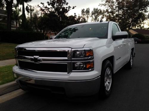

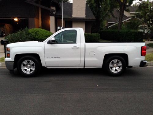

Removed block and 1 inch hole on the drop shackles
Looks great! I was thinking of doing the same thing. Did you run into any problems with the seam on the bottom side bed only using the 1" hole on the shackle? Any problems at all with that setup?
Thanks! No problems with it, rides just like stock. I did bend the seem on the driver side but it was more for ease of access to putting the shackle in.
Do you think it could be done by loosening the bed bolts and lifting it a little. My bed is slightly off set anyway so I could even it out while I did the rear suspension.
You probably don't even have to bend the seem, it'll just take a little finessing lol I just got tired of struggling with the long bolt in the awkward position and trying to get it in.
