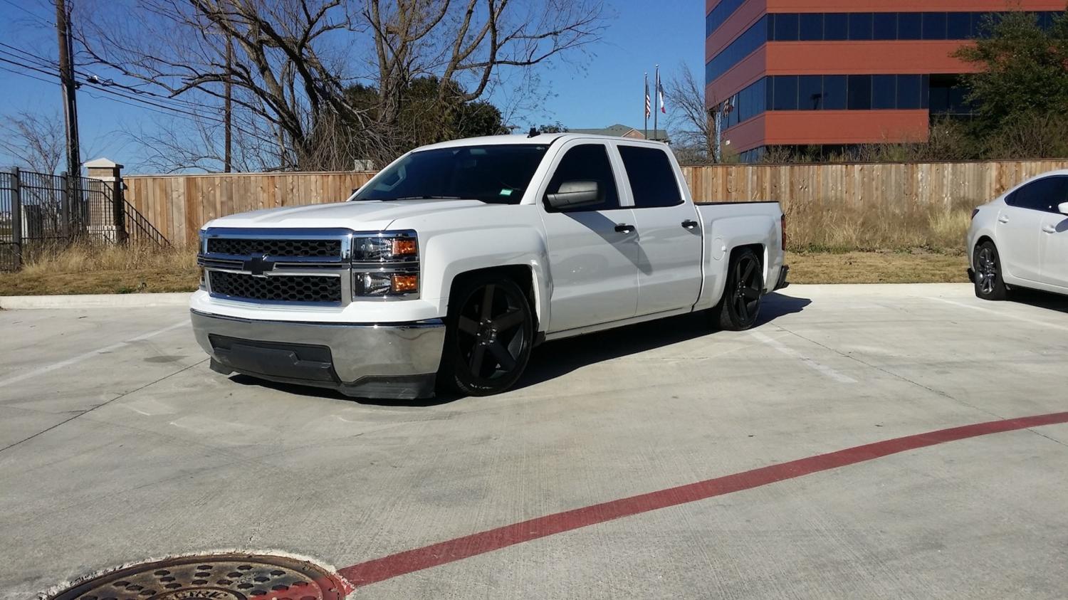

26x9 intro id350. 295/30r26 tire wil be a 5/10 drop maybe a little more up front

truck isnt done yet still waiting on axles for the rear end to come in from moser
Sweet wheels. That thing is screaming for a big brake kit now!

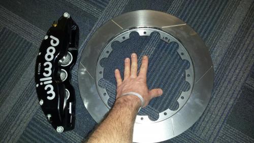

These would look amazing behind those wheels
yeah , goals for sure. im gonna look up a few different companies like baer, r1 concepts etc, the 16" rotors are def nice.
