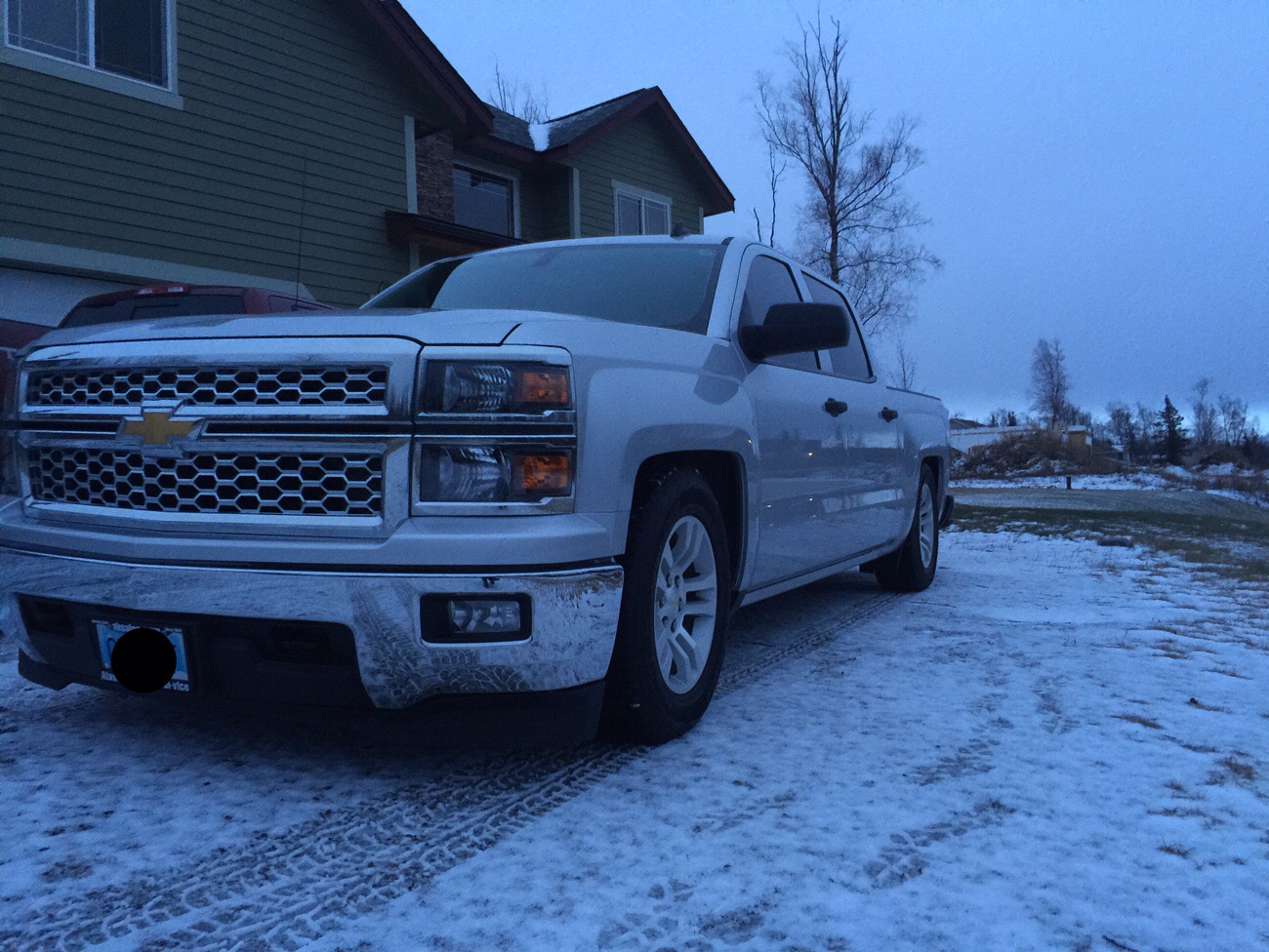

Here is some pics of mine after a cleaning 3-5 McGaughys
Thanks for the great pics! What size tire are you running?
I am looking to do something similar to this with a RCSB 4wd. Looking for a 2/4 or 3/5. It has aluminum control arms and aluminum knuckles up front. Is there a way to get a bit more rear drop to eliminate the rake without going to a flip kit?
My truck is a 4WD.
DJM front and rear kits installed. 2" drop Control arms, 2" drop shackles and 1.25" block removed. DJM shocks on the rear. Stock Rancho shock up front. DJM says nothing about cutting bump stop so it remains stock.
I got a good deal on some OEM 22" takeoff's and mounted 285/45/22 Maxxis MAZ-4S all season performance tires.
I'm very happy with the stance as I like to have some rake. The ride is firmer due to the 45 series tire and the rear seems to be a tad bouncy likely due to the $50 ea DJM shocks. I'll look into some better quality rear shocks.

Here's my '14 with the aluminum front end. DJM 4" kit (2515-4), and Belltech flip kit. Factory 18" wheels on 265/65r18. On level ground, it sits at 32" front and rear.
