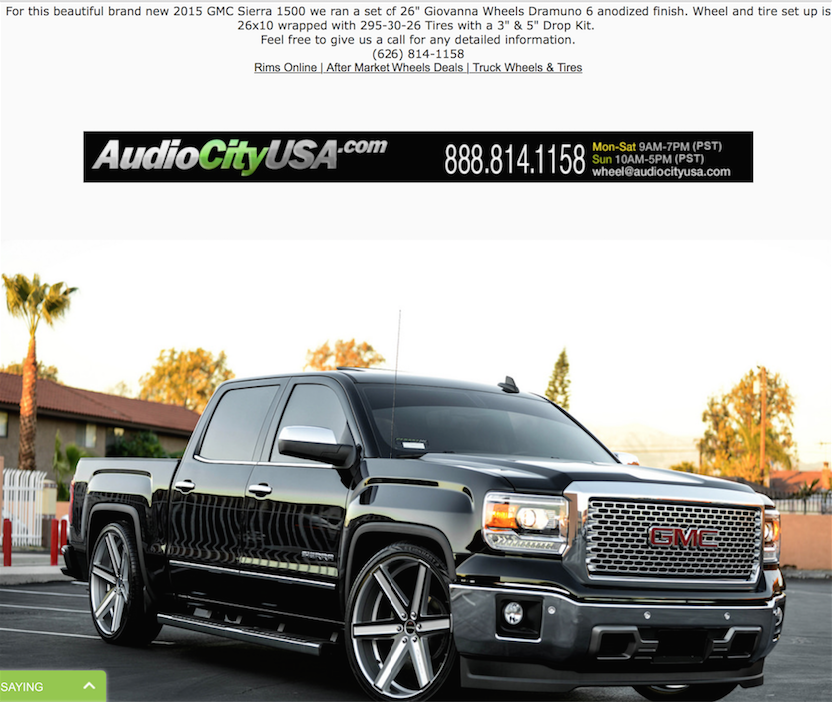

Im looking at lowering my 2014 Denali. The stance on the truck in link looks just about right. Im going to try to get the details on the lowering kit used for this with similar wheel size. Says 3"/5" drop kit. What do you think?

Is your's a 2 or 4 wheel drive? I've read you can get some driveline vibration issues going much lower than 3-4 in the rear. I'd bet that truck in your photo has a 5/7 drop, but who knows since the massive wheels may make it look more lowered.
Not true I have a 3-5 Drop no vibes and drive shaft issues either.
http://audiocityusa.com/board/416689
Here's the link for the suspension used on this truck above.
http://www.maxtracsuspension.com/2014-silverado-sierra-3-5-lowering-kit-short-bed-spindles.html
