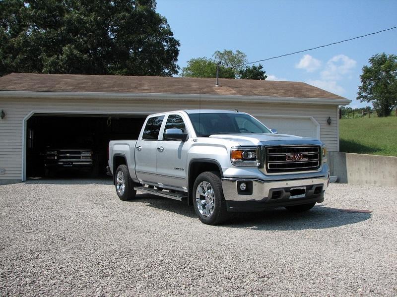

tn_gallery_2071_2021_4933.jpg Yeah, it is pretty unusual to back one's vehicles into the garage. The Traverse has Homelink and the Silverado has Lear; both work as soon as I turn into the court (~300 feet from the garage).
