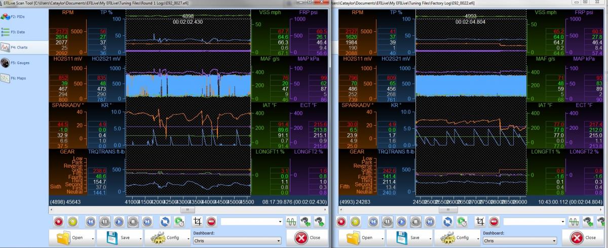

Yep, it is still there, none at a 55 mph cruise though now. It is actually running more timing now but I am not sure if this is in the tune or due to the engine load being decreased with the 4.56 gears. The Logs I ran initially were with the 3.42's so it's not really apples to apples. If I pull the tune out I will do another log so I have something better to compare with.
The left chart is after the tune and gear change the right chart is before running 35" tires with no computer adjustments. The white numbers in the cart are the mean / averages. Both were running 89 octane. You can see on the left one that there is more timing / less load and less KR. Like I mentioned I will pull the tune and see what it looks like with just the gears so I will have a good base to go off of.
Edit: 89 Octane not 98. Dyslexia kicked in.
