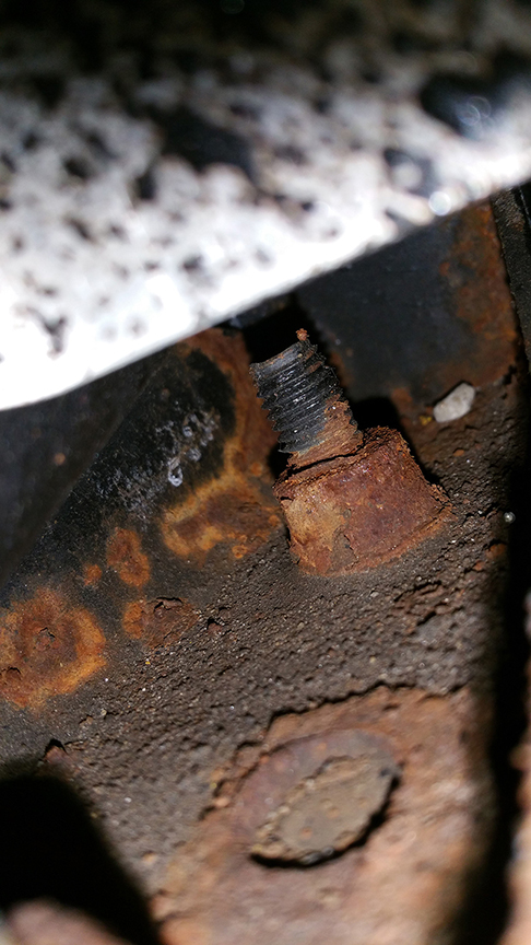

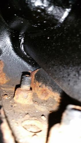

My 10 month old truck GMC Sierra SLT 2014 frame is rusting fast.
Are you kidding me with this?? Never seen it this bad, seen bad as GM has the absolute worst frame rust out there. But, this is unacceptable.
Can you show us a few pictures of the truck that give us context? I'm north of you and my Aug 14 build looks lole new despite living north of you. That is definitely not normal. I would expect rust like that after 5 years without washing off road salt.
Shit, I wouldn't expect rust like that after sitting 50 years in the ocean! Somethings not right with that picture.
The only truck I've seen rust like that was my coworker's Toyota Tacoma. After the recall he bought a new one. It's rusting just as fast.
I don't have the truck anymore since GM did the Trade in assistance with me but this pictures are from 2 weeks ago, one picture is the driver side and the other is the passenger side. The truck was rust proof numerous times over the 10 months I had it,
Damn that looked pretty terrible. I jusst noticed the pictures and info you had posted in a different thread. The attempts GM had the dealer do were pretty unacceptable. I'm glad to hear they worked with you on a trade deal.
I brought my 5 month old 2015 Silverado to the dealership I bought it from and was told "surface rust is normal". Funny thing is the 10 year old Silverado I traded in had less rust than the 2015 I have now. I called and made a complaint with GM, hopefully it gets resolved.
