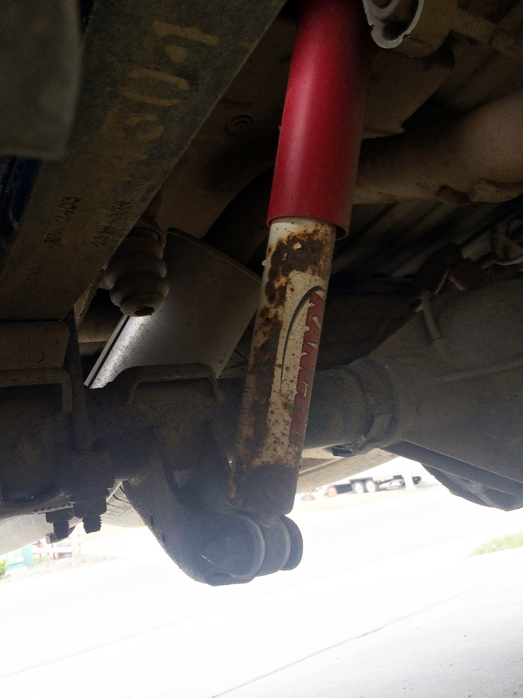

Here's what mine looks like.
LOOKS LIKE JUNK.
I bought this truck beginning of October 2013. So about 19 months old now.
2014 GMC Sierra All Terrain.
As somebody who works FOR a company that does the marketing for GM, I am starting to get VERY sceptical when GMC is launching slogans like "Precision Truck Event" and "GMC, Precision Matters", etc.
Look at my shocks for example! Seriously?!
