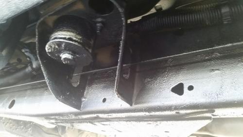

Build dates 03/14 and up have an additional clear wax sprayed over the black stuff. Its a lot harder and I have 0 issues with rust on mine.
Probably what was suppose to be done at the start of the 2014's but GM figured they would save a few bucks on the early builds.

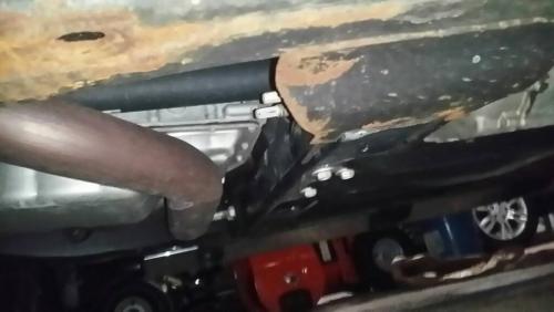

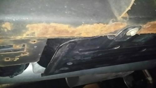

My frame is horrible looking, The entire thing is orange colored with surface rust. I have not see any other new vehicle look this bad. Not even my 2005 tacoma that had to have the frame replaced due to rust. I plan on pressure washing it good this summer and getting under there and doing a good job at painting some sort of frame paint on it. I am not a fan of the thick gunky undercoating.
My truck was an August 2014 Build and I have found that the frame is rusting where there were welds or joints. The flat surface of the frame itself seems to be holding up alright. I know it's just cosmetic and the frames not going to rust through and break but it sure is annoying.
These frames are made of relatively thin walled C channels with some fully boxed in sections where the stresses are the greatest. Even though the frame is not likely to rust through for a number of years, it should be properly protected from corrosion, including the welds. It is not exactly made of two inch thick plate steel.
It's a fully boxed frame, not c channels. That's one of the reasons they dip it in wax to properly coat the interior surfaces of the boxed frame.
