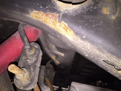

So Frustrated!!!
My dealer painted two small patches in rear wheel wells and basically said there was no TSB.
Guess they figured I wouldn't check out the rest of the frame when I had a chance.
Now dealing with GM customer service...basically playing phone tag for a week.
I didn't order a rat rod!!!
So far VERY $HITTY service from GM

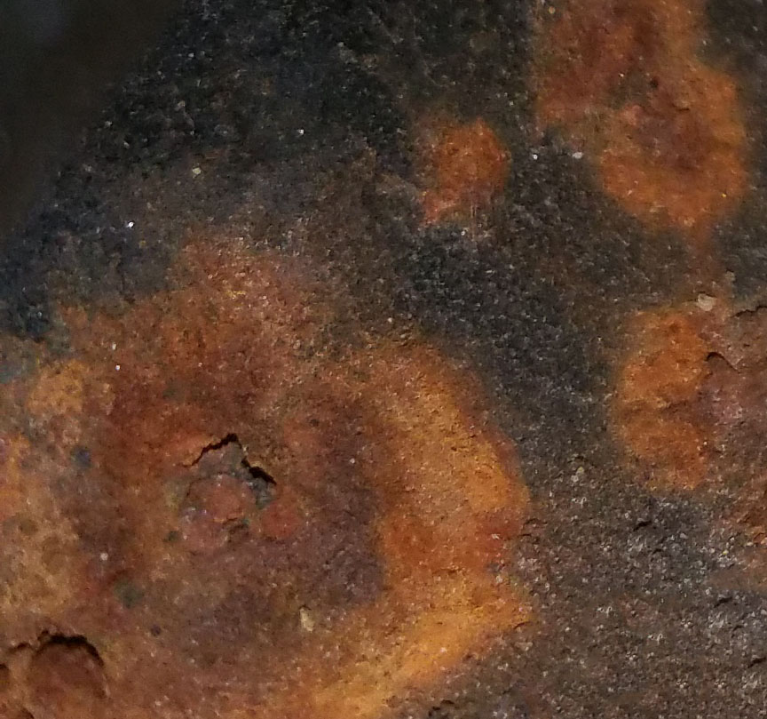

My 10 month old truck GMC Sierra SLT 2014 frame is rusting fast.
Are those holes forming in the frame from the rust?
Yeah, I would like to know if those are rust holes too. That's really concerning. What part of the frame is this, maybe a picture of it zoomed out.
I'm guessing over time we will have a recall on our hands similar to toyotas. Most likely there was a flaw in the dipping process and the frame company will have to pay for new frames for our trucks. My 2005 tacoma didnt look as bad as my 1 year old sierra, but it did have a rust hole through the frame near the catalytic converter. Dana Corp. went out of business because of the loss from replacing all the second gen tacoma frames I was told. On the plus side my 10 year old truck got a brand new frame, lower control arms, ball joints, brake lines and hardware out of the deal. It looked like a new truck before I sold it.
I have a 2003 Jeep Wrangler that I bought new. It has sat outside every day of it's life. It has 135,000 miles on it. The frame doesn't have a speck of rust on it! And that's after driving it through 13 shitty Pittsburgh winters! The 2013 Avalanche that I just traded with only 15,000 miles on it looked like it was 50 years old. Not just rust on the frame, but all the cables and fasteners and nuts and bolts. I liked that truck and lost a lot of money trading it in but looking under it made me sick. The wax coating on my 2015 Sierra seems different/better. Time will tell.
Edited by steelcity
Unless these trucks start snapping in half like the Toyotas and GM's hand is forced by the government like they did to Toyota, I wouldn't expect much out of GM. They've demonstrated over and over again that they will do their best to get out of issuing a recall for things unless people start dying from it or it's a cheap easy fix like a software update. They've most likely addressed it on later builds as people have pointed out here with their 2015 wax coatings and us early adopters of the 2014's will be left out to dry.
