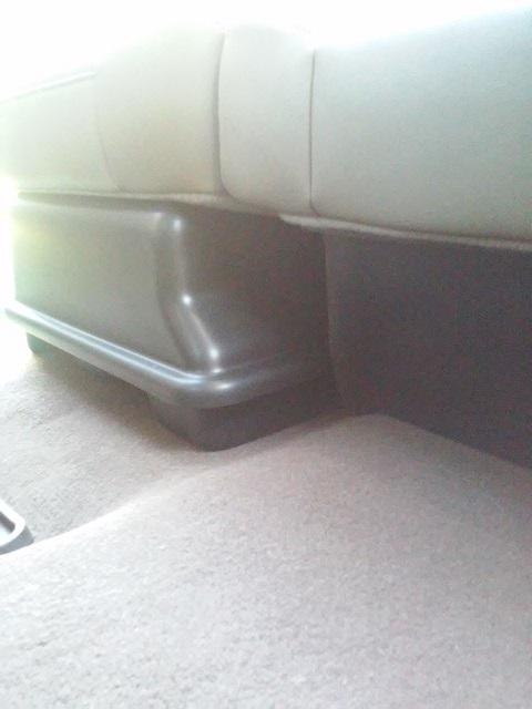

I love this kit and have been enjoying thoroughly for a year now, however my question is about under seat storage. Is there any type of bolt on storage that you can find to fit with the sub, without having to cut 1/3 of it off?

I'm not aware of any other storage from GM, possibly some after market bins though. I took a grinder & cut mine off at the sub, then I cut the very end off of the piece I cut off, matched it to the bin as close as possible, ground & cut it so it fit the best it could, used some 60 second epoxy to attach them together, then caulked the inside and filled the small gaps on the outside with some bronze silicone. I then drilled a hole in the rear lip of the bin and zip tied it to the seat belt tower next to the sub and used the GM supplied mounting bracket for the bin on the drivers side of the rear seat bracket. It took about an hr., but it looks good and tidy all tied together. I can take a pic if you'd like to see, but that was my remedy!

Hey thanks for the info! If it's not too much trouble, yes I'd like a picture of what you did.

Looks good man. Thanks for the pictures as that helps me better visualize.
